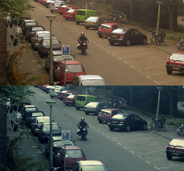

Originally Posted by Take Vos View Post
I've made a new picture that was better calibrated.
http://www.vosgames.nl/products/Mira...ingSolved2.png
I've done some white balancing and set the black level lower (sun was shining into lens).
The white seems to be clipping a bit too much, like on bike lady's shirt. I did some color grading with your first picture, pushed it pretty far... (see attached JPG)
Yes, I noticed the ladies shirt, I was not really paying to much attention (still have to add a zebra kind of thing). But I wanted something a little bit more bright than the image you color graded.
As you noticed it had still a lot of latitude left. You may also have noticed the amount of black offset, there was quite a bit of light falling into the lens then as well, and the calibration I did was done very shoddy (The white target was not evenly lit).
The second image should already be much better, even if it is clipping a little bit to much. Although it looks to me that this camera somehow handles white clipping more gracefully as the DV cameras I am used to.
although that corner stone for that arced window, in the foreground, is not really pretty.
strange thing is that I seem to have compensated for what normally would be considered dead pixels (there are around 8 bad pixels in this image according to how the manufacturer would measure them, and really visible on an uncompensated image). I am doing statistical analysis of each pixel after compensation compared to the theoretical value and I come up with zero bad pixels for an average light intensity above 10%.
Yeah, Your 2nd image (with the clipped highlights) has tons of latitude and detail in the blacks, leading me to believe that you can underexpose a good bit without worrying about noise.
