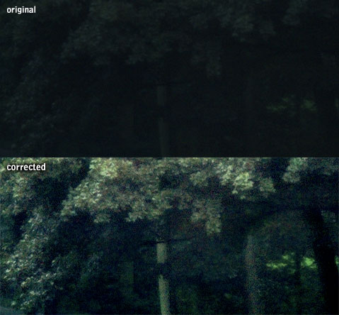

Under exposed image
Hello everyone,
I thought I would share an other picture, this time I made on during dusk, from the trees in the park. So the image is incredibly dark.
This is still a screen shot, so we still don't have the full 14 bits of latitude.
http://www.vosgames.nl/products/Mira...derExposed.png
I am now sending the picture as integers to the graphics card, so I am no longer first converting them to 16 bit float. This would allow for a little bit more accuracy, as the graphics card would internally convert this to a normalised 32-bit float.

If your going commercial with this, it needs to capture at 1920x1080. You'd probably have to go 10-bit log or 8-bit. 8-bit would work well in 16-bit stream (no padding)
10-bit log is what Silicon Imaging is using for their high end 1080p camera. The 10-bit bayer capture codec they are licensing (cineform RAW) is a very efficient visually lossless wavelet codec. Since it is currently being ported to OSX with full quicktime support, you might want to inquire about licensing. They are cool guys..
I "push" graded the under exposed image you posted. (attached) Looks like there still a bit of information there, even if its not 14-bit :)

Solomon,
The end result will be uncompressed RAW 12 bit non-linear (I call this '1412') with a resolution of 1920 x 800 (2.40:1). And it will be direct editable in QuickTime applications like Final Cut Pro.
As for the codec, I think it is too late now, I have designed my own codec to read the calibration data and compensate the image during playback. I have done this, so that the calibration is not fixed, i.e. you can redo the calibration or change calibration method after you have shot the footage.
The bottleneck right now is the Firewire 800 speed, and then after this the hard disk speed (although one could always make stripe set). But I actually like the idea that you can use a single disk to record on.
I could also design a '1408' or 8 bit log encoding, this would allow for a 2048 x 1080 image easily, but I am not sure if you really want to use only 8 bits to encode the image.
As you have probably noticed during the pushing of the image, there is quite a bit of "bias", I think this is caused by reflections inside the camera.
The C-mount which doubles as back-focus is made of bare aluminum. The 35mm lens is probably projecting onto this bare aluminum which gets reflected onto the sensor. I guess I will need to paint it, or design one that is black (but that may be prohibitively expensive for single runs).
I think there is also quite a lot of noise in the image as you have seen. The noise is quite random, so it does give some information about the actually darkness when you view it. I think I will need to shill the camera, so that the noise will be reduced. With a bit of luck noise is reduced by half for every 6 kelvin drop in temperature. Finally one could use make a temporal noise reduction algorithm running as a filter inside Final Cut Pro.
