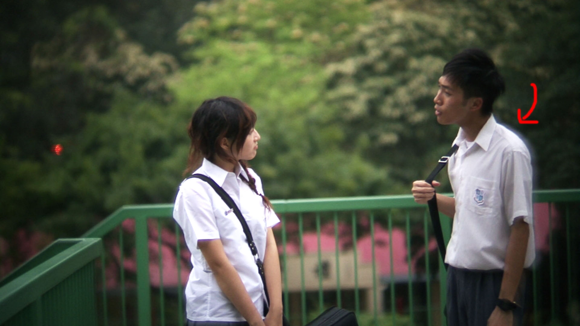

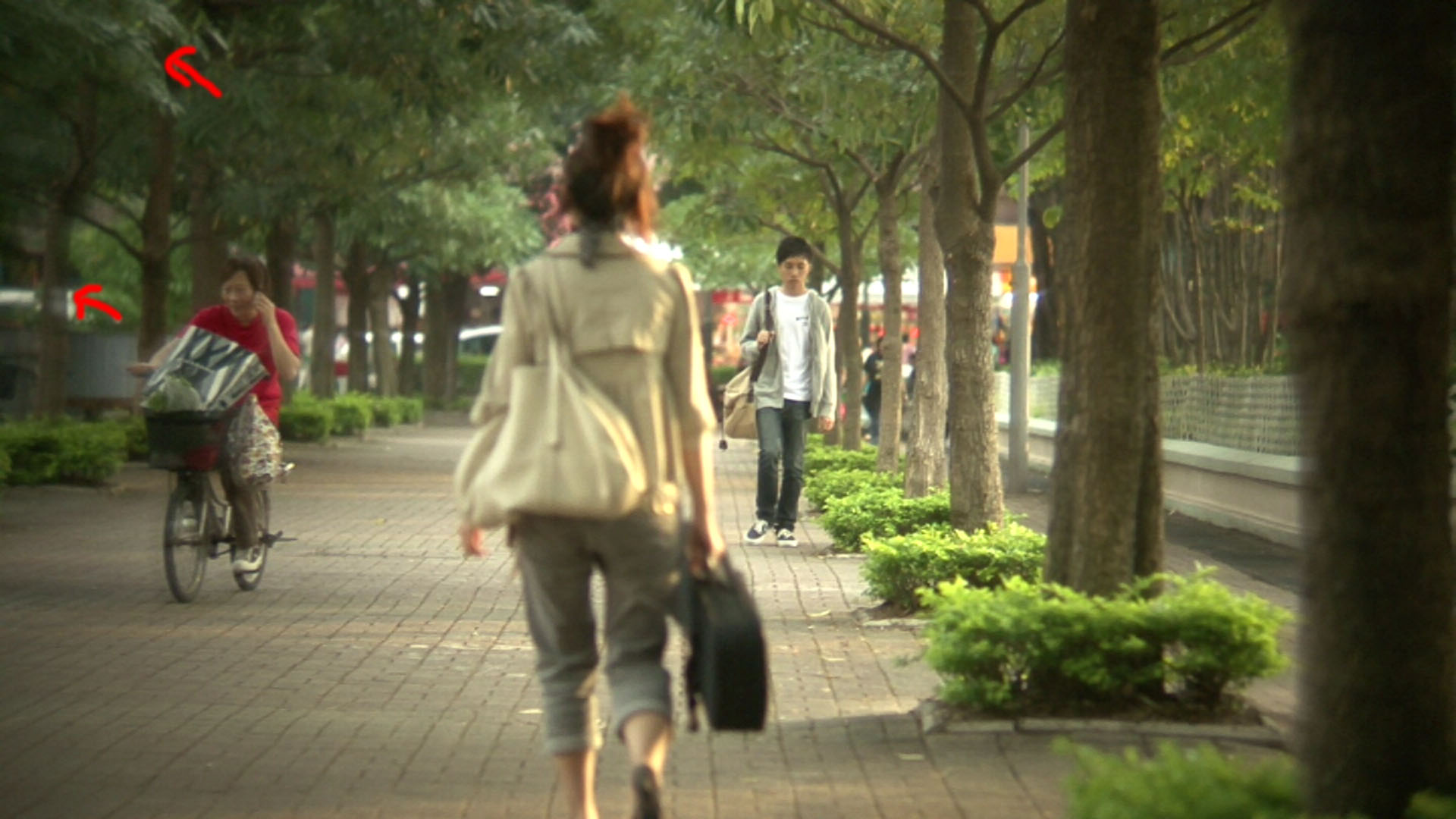

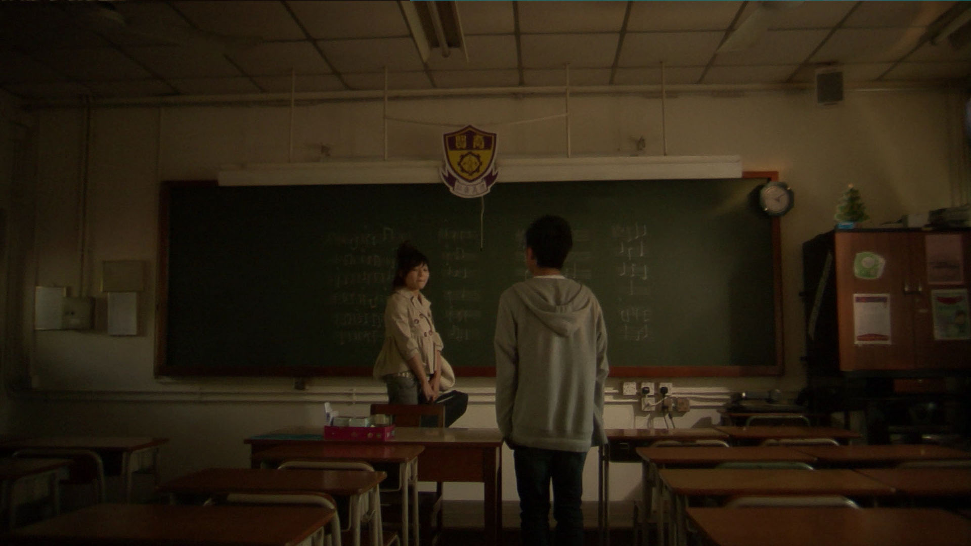

I have developed my own DIY HD ready adapter. Using Canon EE-S screen as GG. And SGPro R3 Achromat.
But Some of the shots have a ghosting effect at the edge area. Is that a problem of the EE-S screen? The matte side of the screen facing the camcorder lens right now. Is this the reason causing the ghosting?

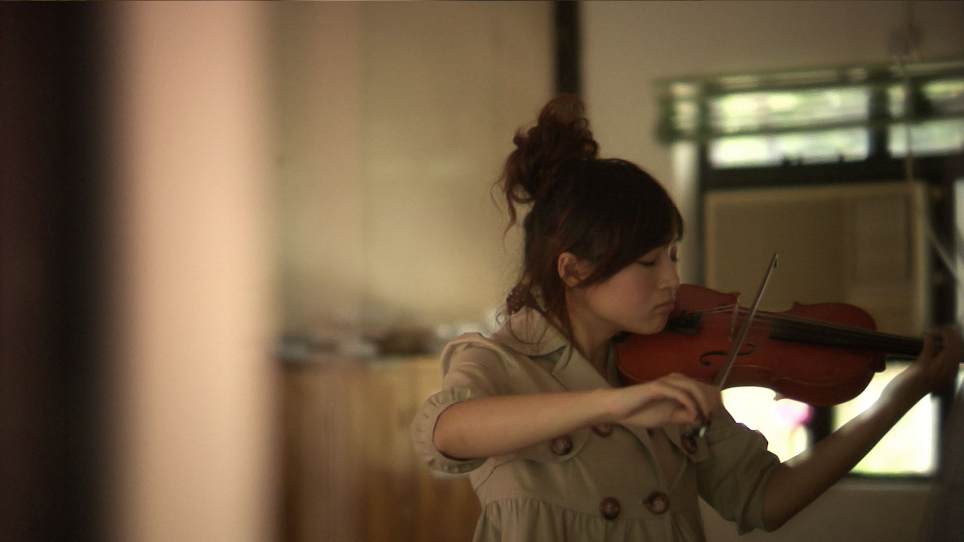

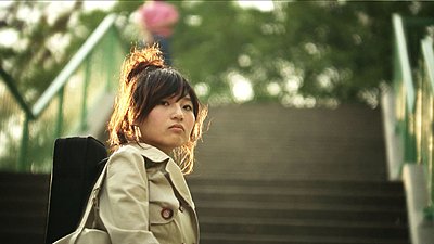

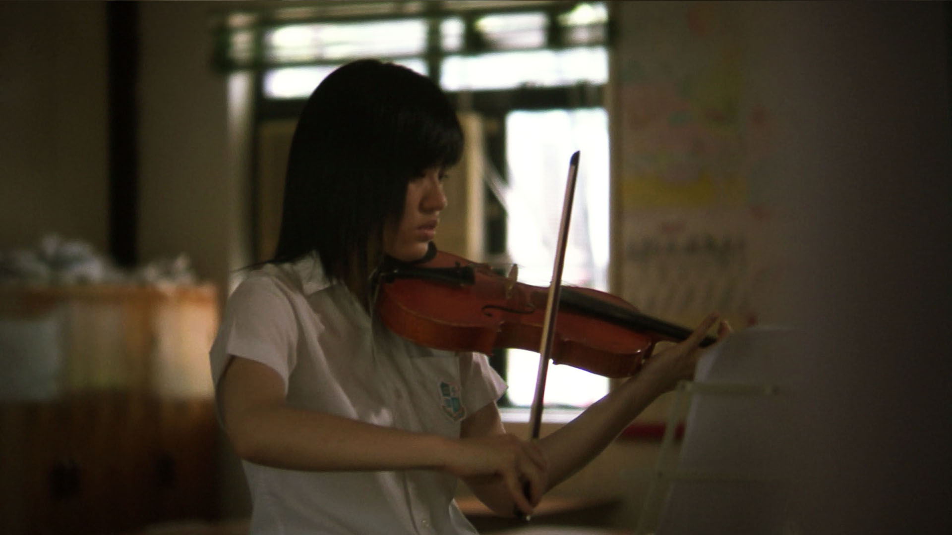

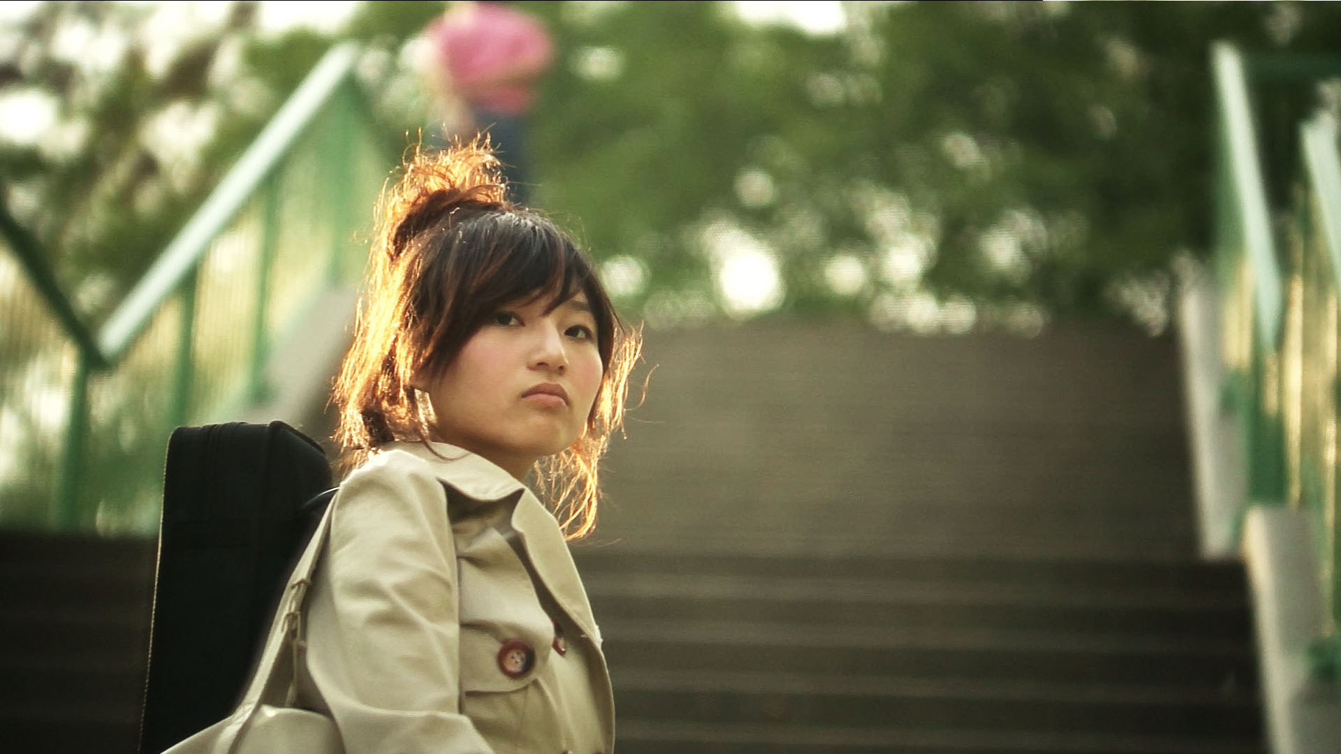

I'm using the adapter with a Sony HVR V1P.
I use my own adapter to shoot my Final Year Project in a film school.
but there are still some technical problems I have to solve.
DIY Adapter ghosting problem. Help.-sequence-03.jpg   DIY Adapter ghosting problem. Help.-f1.jpg

From your grabs, I dont see any ghosting problem that you are refering to. can you highlight the problem a little better?

I think I can see this only on one picture at the right upper corner. Try to put sun behind your subject in a corner and you will probably see those ghosts of light. Reverse your gg, matte to the SLR lens. This is known problem as I can remember. Toenis has said abot that alot. But your picture is superb!! Good work anyway. I am on your trail also, and couple of others too...

But in some certain shots. The edge ghosting problem come out. And it is really annoying. Is that a problem of Canon focusing screen? Damn I bought many of them. And also a hotspot problem.

it looks like you have the ee-s mounted wrong.
Attention!
For vibrating adapters the Canon Ee-S / Ee-A must be mounted this way:
matte side faces the camcorder lens!
fresnel side faces the (SLR) 35mm lens
This avoids the hotspot.
Do you have something else in your adapter achromats, condenser...
that can produce this ghosting effect?
What SLR lens do you use?
Did you fixed the Ee-S at right focal flange distance?

Yes. At that shooting day. The EE-s screen has the matte side facing the camcording and the shiny side facing the SLR lens.
And I was using a Nikon 50mm f1.4.
The achromat is SGPro one so it is less likely the origin of problem.
Maybe the EE-S screen is not suitable for HD? Should I change the ground glass? I don't have a condenser.
I can't find a better GG than the EE-S right now.

1.)EE-S has nicer bokeh than EE-A screen at wide open aperture e.g. look at f1.jpg

I have been trying to see the fault in the image, now I can.
I think you may be trying to get too big a picture off the groundglass which will be causing the hot spot. A groundglass which is too transparent will make this happen too. It has been a reported issue with the Canon screen.
I understand the Canon screens have a fresnel patternon the shiny side. If I am wrong ignore everything I say here.
If you have more than one Canon screen, try putting two together with the groundglass finish face-to-face. You will the have in effect this path :-
Subject >> SLR lens >> fresnel (condenser) >> groundglass|groundglass >> fresnel (condenser) >> Wayne Kinney's achromat >> camcorder.
If you are moving or vibrating a Canon screen with includes a fresnel (condenser) function, you may not get good optical performance outwards from the centre because the fresnel (condenser) optical centre axis is being moved off alignment.
Any defect will likely occur towards the corners or edges where the light bending effect is at its greatest. This may be where your peripheral radial blur (what you call ghosting) is coming from.
"Ghosting" is the maybe wrong word to describe the problem. In groundglass talk it has come to be the word used for a fuzzy outline around a sharp bright object which becomes a problem when the groundglass is too transparent.
Your problem looks like it is optical and moving the fresnel (condenser) elements may be the cause. The fresnel elements may be doing this on their own.
Shoot some images with the motor switched on and with the motor switched off. If there are changes, you'll know this is the cause.
Zooming in closer on the groundglass for a smaller image area, may fix the hotspot with a static groundglass but with your moving groundglass, the edge defect or ghosting as you call it may remain.
I am really only guessing here so don't pay too much notice to my comments.
Don't grind your screens. Face-to-face will increase their opacity and help deal with the hotspot. Make sure they are both firmly locked together. Otherwise if one moves against the other there will be scratches or polishing of the groundglass texture which will cause marks.
If the movement is the cause of the problem, there will be no cure unless you can separate the groundglass screens from the fresnel optics. If they are made from one piece of glass then you cannot do this.
