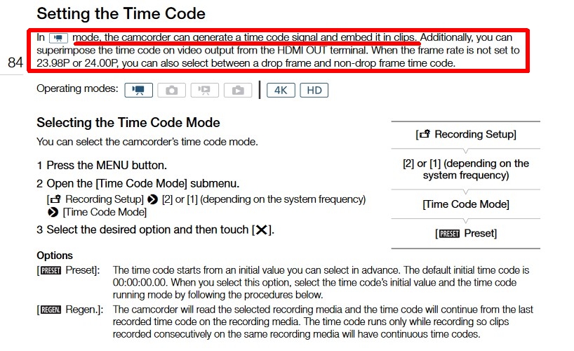

As far as the XC-15 goes it DOES embed timecode into the clips it creates. If your Atomos will not read that embedded time code on playback of your files it likely means one of two things. 1) As mentioned above the Atomos is not set to read the "embedded code" or 2) the XC-15 even though it generates and embeds the time code in the file is not putting that code out across its HDMI port on playback. The later is the most likely.

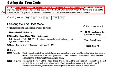

As for confirmation of the embedding of the time code into the files check out page #84 of the manual. See attched file.

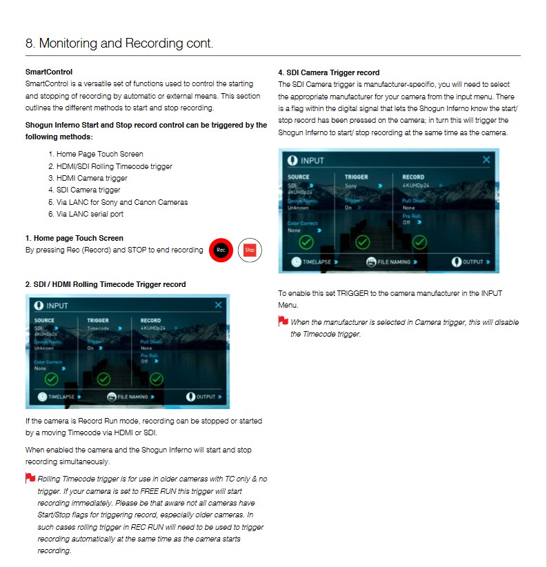

Also look at the Atomos Inferno menu page #23 with particular attention to the "2. SDI / HDMI Rolling Timecode Trigger record" section. See Attached file.
Try these suggestions and see how you go. You may have to trigger 'record' manually on your Inferno if the XC-15 doesn't put out a trigger via TC when you hit play on the camera. All things being equal what I have suggested should work for you. What you want to do is something we do frequently and have done so for years without issue. Though never with an XC-15 so good luck.

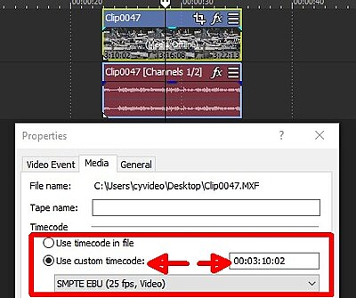

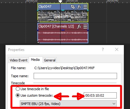

I don't know what system you edit on but a lot of NLEs have the ability to assign a time code value to clips. If I have the problem you are describing I just apply a custom time code to the ProRes clip to match a given time code, such as in your case the time code from the the first frame in the camera clip. This is essential for cuing up multi-cam clips from different cameras with non-synced time codes. See example custom time code setting image below.
