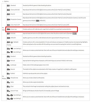

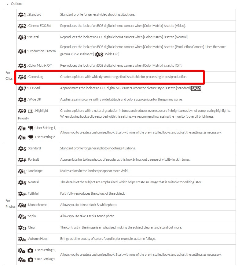

Nick. If you are delivering in Rec 709. Which is the standard for most TVs, DVD and BD delivery then 709 is what those bits of hardware are expecting to see as they are all 709 calibrated devices.
For shooting, the XC-15 doesn't offer you the option of Canon Log 2 or Log 3. If shooting the XC-15 using its LOG setting then the correct monitor LUT to view with would be the Rec 709 one. Afterwards in post you can then apply a Transform or 709 LUT to to your LOG footage to suit. Then generally grade for Lift, Gamma and Gain PRIOR to the LUT if using LUTs.
