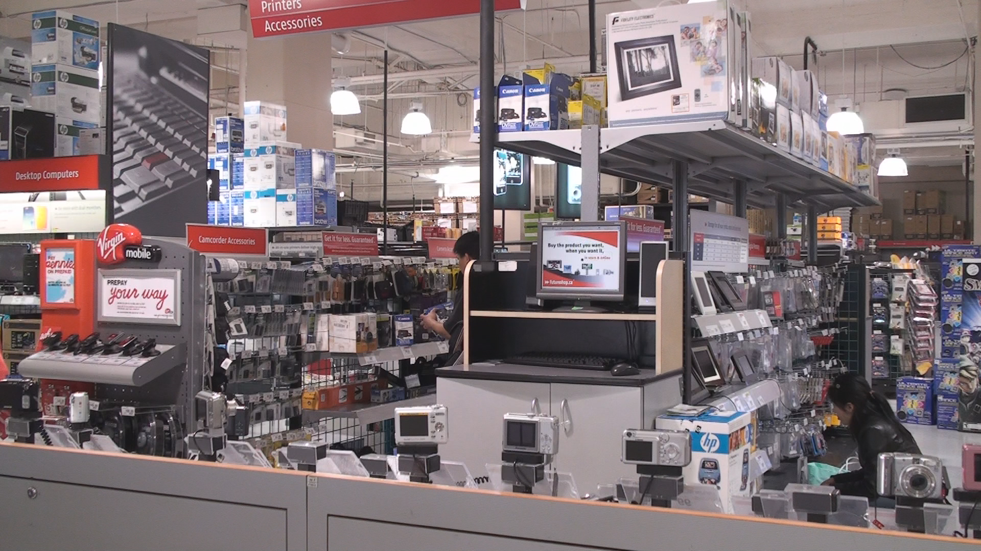

Tried a SR12 at a local store...
and frankly, I'm not impressed by the AVCHD compression.
I'm recording to memory stick at Full HD resolution and after downloading to my computer at full resolution, looking closely in Vegas 7.0e, I see a TON of blocking artifacts in the reds and blues in the scene which is extremely complex with tons of contours/features to encode... Consumers wouldn't mind, however it can't be accepted by pro standards, considering everything that is broadcast is recompressed VERY often.
The only way I'll buy a SR12 is if I need it for high resolution chroma keys via my Intensity Pro.
Then there's the problem of the "rolling shutter"...
Looks like the superior compression of HDV might stick around for me. I might even go for XDCAM HD if I had the money or if I was hired by the right people...
I've provided a screenshot and you can clearly see the blocking in dark areas and the reds. (Compressed at max JPEG quality)

Can't see any evidence of it with moving video on a 60" Pioneer Elite 1080p plasma. I was never a fan of using stills or frame grabs for determining the quality of moving video. Compared to my HV20, I see absolutely zero difference in artifacts.

All I'm saying is it's unsuitable for broadcast HD. Recompress it enough and it won't look as good.

Hi Jack -
Did you shoot the same exact scene with an HC9? The reason I ask is that unless you did so, you're not really making a fair evaluation of AVCHD vs. HDV.
I see a VERY complex scene, with a substantial amount of detail in both light and shadow areas, and only upon very close examination could one quibble over the quality.
Remember this - it's an old "art" concept... when looking at a painting, if you stand close enough, it looks like poop, but if you stand back a distance, you see the "picture", not the brushstrokes, pigments, etc.
It's really quite the same with video - if you get close enough, it's ultimately a bunch of colored dots/squares/rectangles REPRESENTING a picture of a moment in time.
In my mind the question is one of how accurately that picture captures the color, detail, and "feel" of a moment, over a wide variation of conditions in which those moments occur.
I was very happy with the HC7, but my CX7 to my eye (yes, with last generation AVCHD vs. Last generation HDV) gives a better result under many conditions.
I'll suggest you go back, shoot identical scenes with an HC9 (which is a slight but noticeable improvement over the HC7), and the SR11/12 - post those and look at them side by side (keep in mind 1440 vs. 1920 horizontal resolution) - let's see what the REAL story is.
Simply tossing a frame grab up and declaring it's not fit for prime time is rather shortsighted.

I have a HC7 and am very happy with it, I do notice that HC7 images at full size are softer than the SR12 but has much less ringing than I saw in my SR12 trial. Take a look at the word "Accessories" in my screenshot. Lots of ringing artifacts are present in that portion of the video. Looking at a red section of one of my HC7 videos, I see less ringing. Both are handheld.
The above is when you consider the details. However, to make it fair and balanced, I will say that they are pretty much equal in quality when you see the whole picture.
