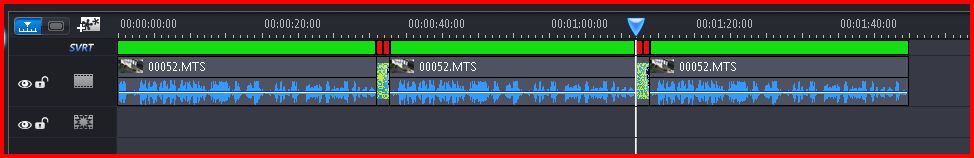

Old December 1st, 2008, 09:03 AM   #140
Location: Eggertsville, NY
Posts: 528
Juan,
I did your 3 trials, and found smart rendering to take place in ***ALL 3*** cases, with the transitions adding some extra delays as woiuld be expected.
Note the attached jpeg showing the smart rendered time line in green for the clips and red for the transitions.
I took 21 seconds for the 3 clips with no transitions, and 87 seconds for the 3 clips with all transitions.
Larry

Old December 1st, 2008, 10:07 AM   #141
Location: Canada
Posts: 9
Thank's Larry, I noticed that you clip is a little bit longer (30 s) than mine (17 s), perhaps that's my problem. I will try with a longer clip.
I get exactly the same smart rendered time line than you, however my experience was as described in my last post.
Juan Castle is offline   Reply With Quote
