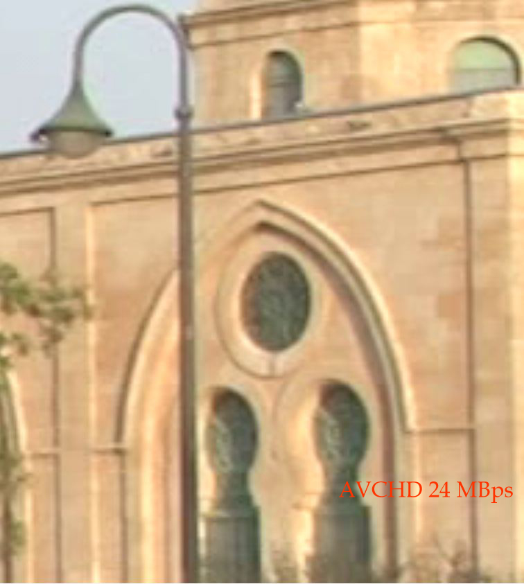

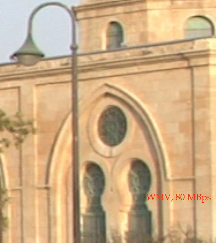

1. I was disappointed in you when you said that “If the processor can't cope it will stutter or drop frames - not just introduce a few more artifacts”. No David, it is not that simple. Decompressing on the fly (i.e. while replay) is much more complicated process. In the case of near 100 percent overload, yes, frame dropping and stuttering may take place, but what if the load is less than 100%?
2. To question “What basis do you have for saying that higher bitrate AVC will need less processor power than lower bitrate AVC?” I say it based on the compressing rate: the higher bitrate, the less the compression rate of the media.
3. When you argued about percentage of lossless and lossy algorithms within AVC compression design, you unfortunately made me disappointed even more: to say that AVC has a lot of lossy compressions is one hell of an exaggeration.
4. You were right when expressed doubt about whether the difference between two fragments were real and not introduced by statistical noise. So, I have prepared another pair of the fragments cut from an original footage (AVCHD, 24 Mbit/s) and the rendered clip (VC-1 format, maximum bitrate 82 Mbit/s).
Look closely at the window frames of the mosque and the sky near the lamppost. As you can see, the rendered at 80 MBps movie has less artifacts and more subtle details.
AVCHD video at higher bitrates-pic-1-quality-vbr-.jpg   AVCHD video at higher bitrates-frame-1.jpg

It seems to me that the main difference is brought out by the way the stills are extracted. Both streams are long GOP but trans coding to a higher bit rate will yield more information each frame for the still extraction to take. There are big differences between how my various NLE's extract stills with Vegas being at the bottom of the list. I don't have VLC to compare. PMB does the best which has a specific feature for still extraction which may well use a different approach.
The video playback may well be the same unless the transcoding employed some upscaling like the Toshiba Super scaling used to upscale SD to HD which produces similar results to the stills shown. I have Cineform and also use Canopus HQ neither of these shows any difference on video playback to the original AVCHD.

That is a valuable point, Ron. Really, a process of still extraction may significantly contribute to appeared difference.
My answer is this. Since I use the same software (VLC media player) to extract and play back the clips, the same mechanism, which might yield more information during still extraction from the clips, should also be in play during the clip replay. Thus, whatever the reason, with the increase of bitrate we would have the improved footage.
Regarding VLC itself, I can say it has a plethora of internal codecs, including H.264/MPEG4 AVC encoder (x264) that is far advanced that Windows 7 Media Player has.

Dave, your last comments were right on the nail! Even I myself if tried to wrap up the moral of this discussion, hardly would do better.
Yes, it’s absolutely correct that the H.264/AVC video format (used by AVCHD) is capable of nearly lossless coding. In practical terms it means, that under right circumstances we can expect the exact (or almost exact) restoration of the compressed data.
Therefore, it makes possible to decrease the compression rate of the recoded AVCHD video (by rendering it into some particular format) before and play it back afterward.
But, the problem here, as Dave elegantly put, is reliable media for the playback of such high-bitrate video. Ask yourself how you can run 80-Megabit-per-second video and I am sure the only answer you would find right now is a pretty fast hard drive coupled with a powerful processor. Zero distribution options, no archiving.
So, until that wonderful moment when industry will come with a commercially profitable solution how to playback high-bitrate video, it will stay only in our computers.
P.S. Just saw you last addition. Unfortunately, I have no more time to write, but, in general, yes, you have guessed right: I used a tripod when I filmed these scenes (and no panning, no zooming).

But that's not what I said. Look back and you'll see the words are "It may include some lossless algorithms, but it includes a lot of lossy ones as well!" - the spec has lossy algorithms as well as lossless ones. How lossy the compression itself is depends on factors such as bitrate - if it's very high there'll be little loss, if low (as when AVC is used for web video) the losses will be very large. What you can't say is "by its results the H.264/AVC compression can be classed as lossless one".
Look, the latest pictures you've posted show visible artifacts - thats the whole reason you've linked to them. Surely that itself is proof that H.264/AVC is lossy?
If they aren't the same frame, original and recompressed, there is really little point in comparing them. Any differences seem pretty slight anyway.

Regarding the two mosque shots:
To my eye, the original shot (24mbs) looks better.
The 80mbs image has a little less contrast and that may give the appearance of more detail in the darks, but the same detail is in the 24mbs shot as well if you look closely.
If you decompress AVCHD and recompress again to AVCHD, even at a higher data rate, you will loose additional data.
Unfortunately, that's the bottom line.
Bob

I saw the little bits of noise in the Mosque shot, particularly around the light, that's one of those "artifacts" that personally drives me up the wall - the sky is a smooth tone, and doesn't have a flock of mosquitos. As for the window detail, I thought the 80 Mbs sample was a tad cleaner - this is one of those "judgement calls" on image quality - I've seen people prefer an image with crushed blacks that tend to give a more contrasty overall image, but there is less shadow detail - I myself lean the other way, prefering more gradations of shadow, but the overall image will look less contrasty - just a personal preference.
If the processing power (or the memory size) isn’t up to the task (or the bitrate is constrained to a low limit), the fidelity of playback deteriorates (by throwing away some of the macroblocks or even the picture slices). This is, of course, has nothing to do with the faithfulness of the compressed video, which can be restored (decompressed) in some other way.
I hope this crush introduction into coding technique answers all questions raised before in the course of the thread.
No, far from it. The first paragraph implies that whatever bitrate the original video is compressed at, the original can always be reconstructed by a powerful enough computer. If true, the expectation would be that playback quality would vary widely with the power of the hardware it's replayed on.
But that is not the case in practice. Quality is independent of the power of the decoding computer - until a lower threshold is approached, when playback first becomes stuttery, then fails completely. The compression quality is a function of the individual coder and bitrate - not the replaying equipment.
At AVC-HD bitrates, H264 will have to discard information at the coder, and once lost, it's lost.
