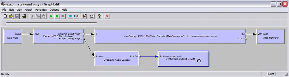

to help debug download GraphEdit (http://www.stokebloke.com/video/wmv2avi.php). Run GraphEdit then drop your m2ts file on the window. You will see something like this attached image. If you have a suitable Demux, video and audio decoder the "graph" will build and play.

OK, I dropped a file into GraphEdit. "Some of the streams are in an unsupported format."
06.m2ts (output)-(input)Elecard Pmeg Demultiplexer-(in)AC3Filter-(out)Audio Input (rendered)
So it is missing the MPEG Decoder on the Graph. So there are no 'arrows out' of the h.264. So obviously it is not rendering the video.
I clicked on the blue square to try to 'insert a filter into graph', but haven't found the appropriate filter yet.
Derek Weiss is offline   Reply With Quote
Old April 14th, 2007, 09:33 AM   #28
CTO, CineForm Inc.
Join Date: Jul 2003
Posts: 8,095
This suggested you haven't install the Elecard player (or similar.) Or you PC will not let you install those components. Or you have something else that is killing Elecard. Sorry I can't help with that, you will need to contact Elecard or the vendor of the components that aren't appearing in GraphEdit.
