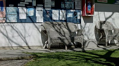

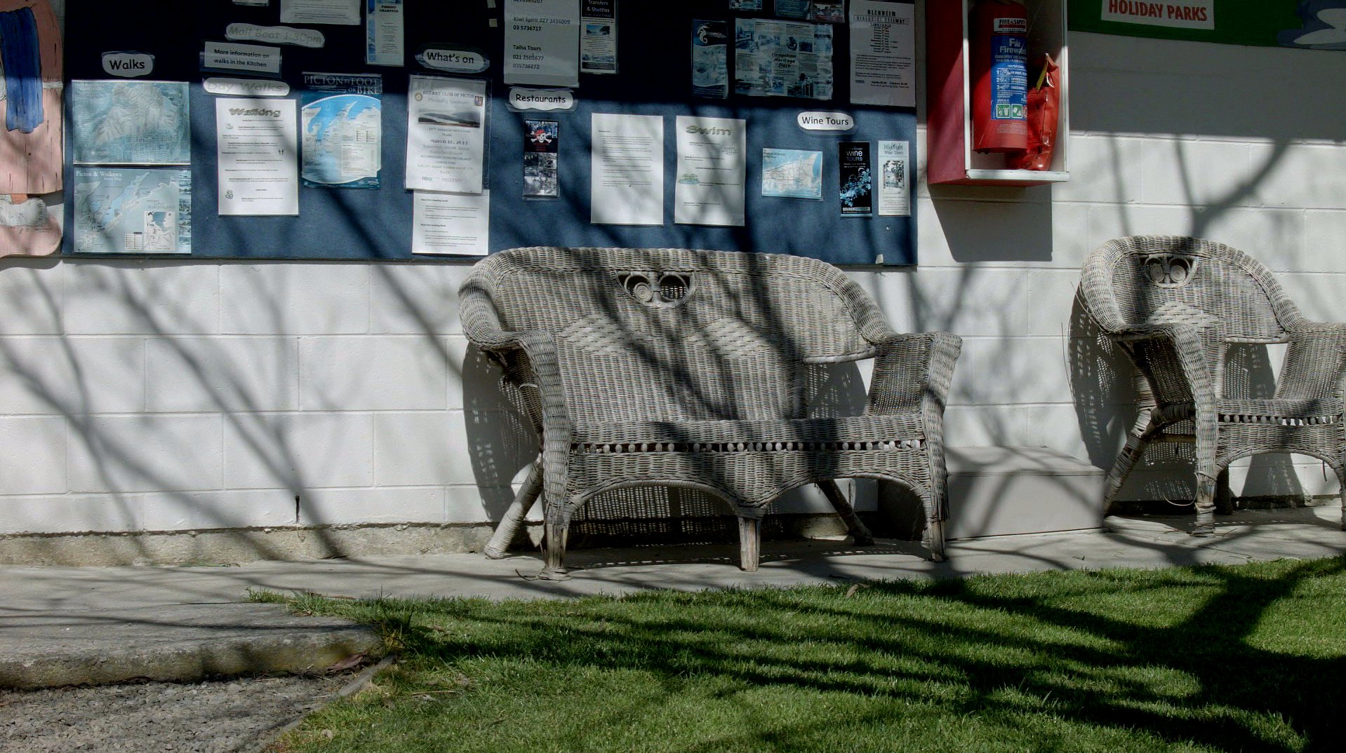

Try to create some moire (I assume that's what it is)
On a Canon APS-C I find it mild enough to miss when just fooling around, even though it crops up a lot.
On some early BMPCs footage you don't see that sort of thing most of the time, but when you do -Pow-, there it is.
Murray Christian is offline   Reply With Quote

Nothing yet. Here's a prt scn where one might have expected to have seen problems.
John McCully is offline   Reply With Quote

Yeah. Thinking I could probably use some examples in case any one asked I tried to find some in the recent footage going around. Haven't been able to yet. Not sure what I saw previously. It's quite possible it was actually on a different camera altogether.
