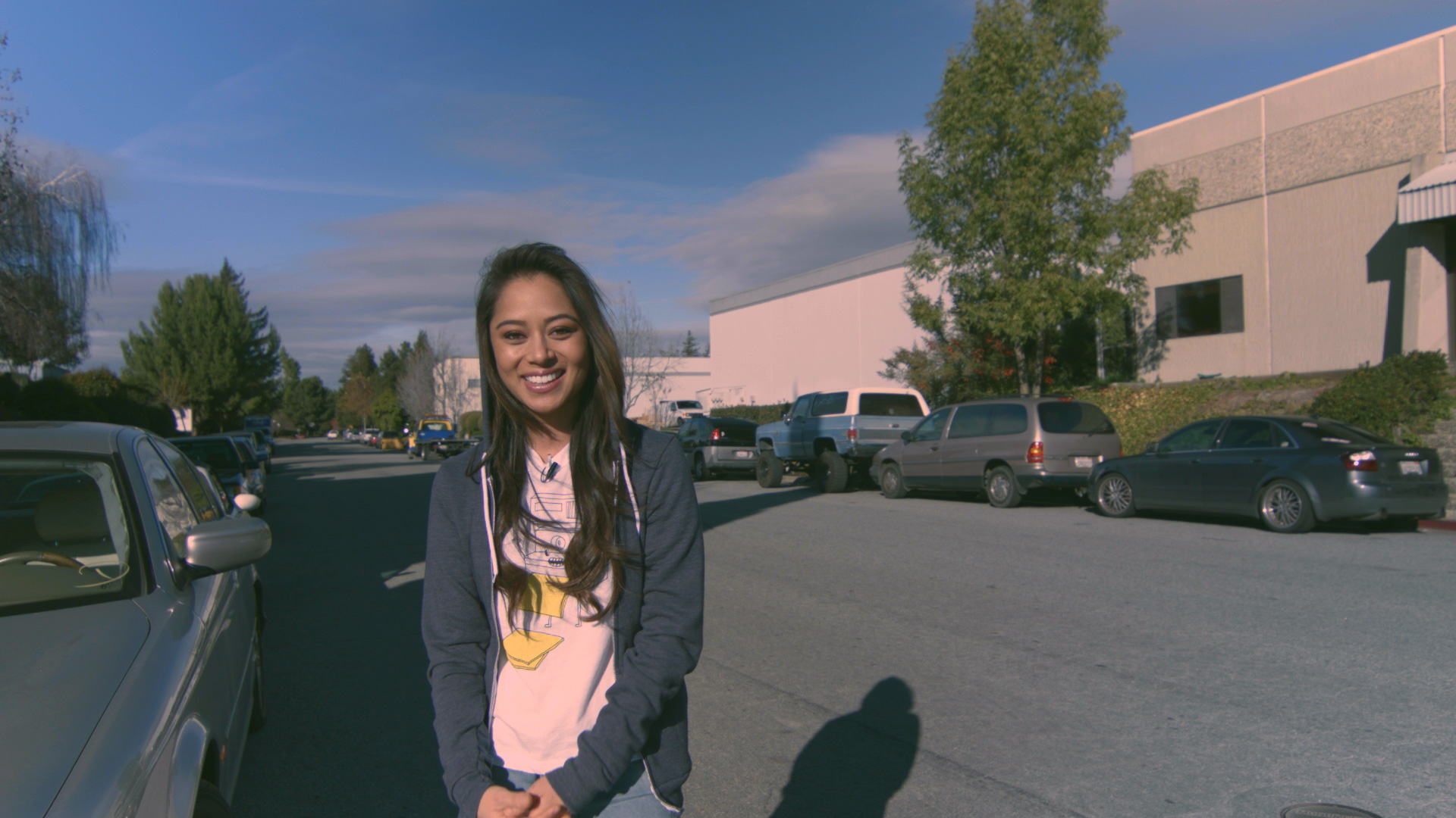

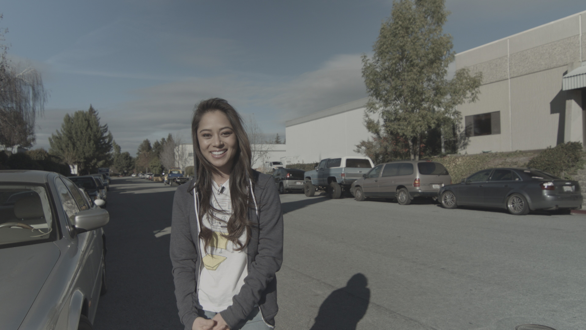

Is there anyone willing to make available a very short piece (even second would do) of a prores files straight of the pocketcam where that "strange" color is best visible, if possible maybe a shot from a person. I just want to see for myself if I (and maybe others?) are able to get some life in the footage and to make skin color look like it should. Or maybe there is allready some available and if someone can share a link that would be great.
I just did some quick and dirty color correction in Edius 7 on that oliviatech sample from the 2,5k bmc camera that has been made available to experiment on, see a before and after below, what do you guys think? I actually don't have much knowledge in colorcorrection and that's why I like having a camera like a gh3 that can do it right out of the box, I probably would get frustrated with the pocketcam as well trying to get the color I want.

Go back and adjust the overall color balance. Look at her t-shirt and the store wall, they're pink and they should be white. The levels have improved though.

the question is if you have to start grading such flat footage, how do you know what should be white?
