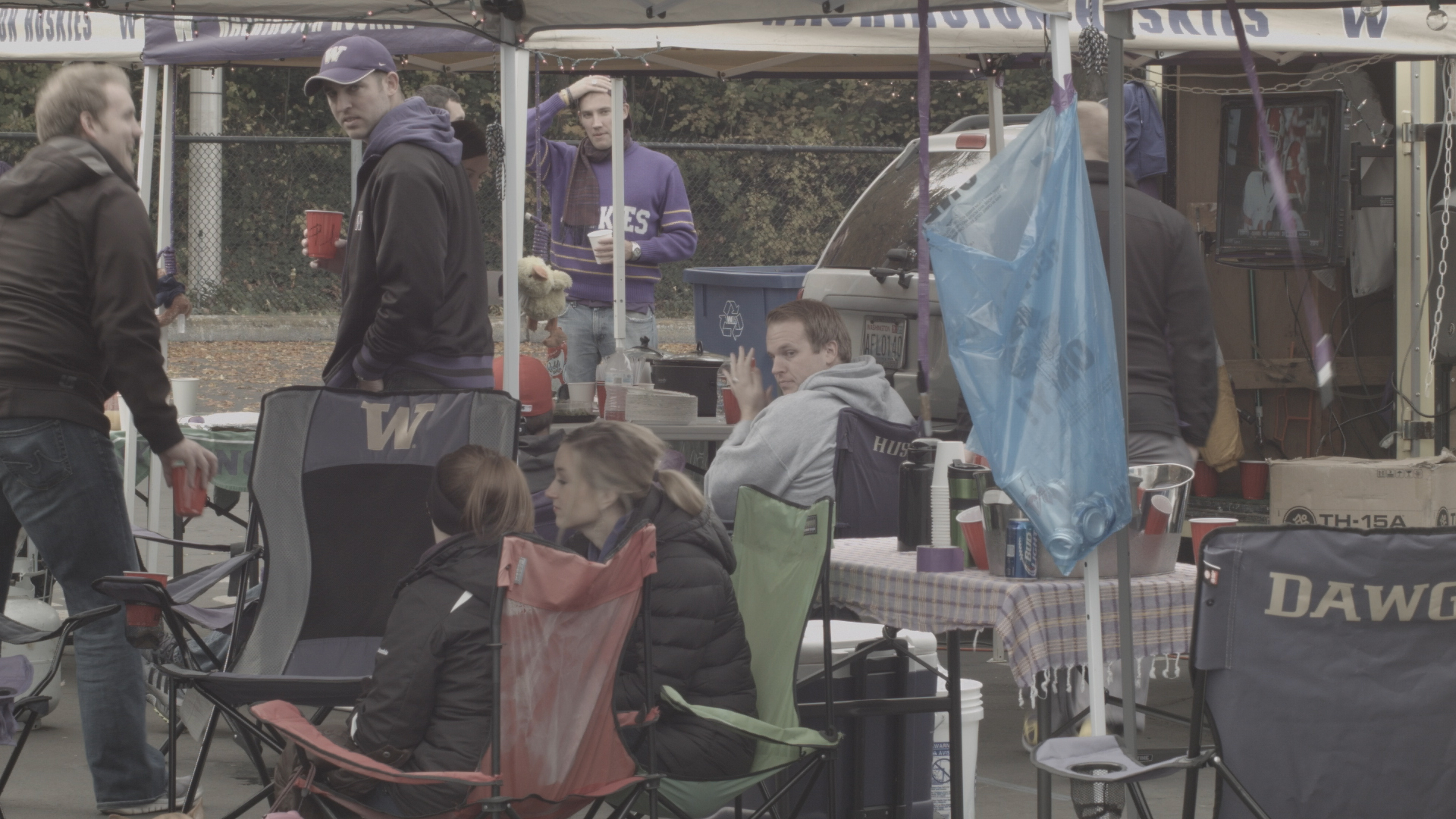

This took all of about 30 seconds to do in AE.
Color...is it me?-no-grade-01_00145.jpg   Color...is it me?-grade-01_00145.jpg

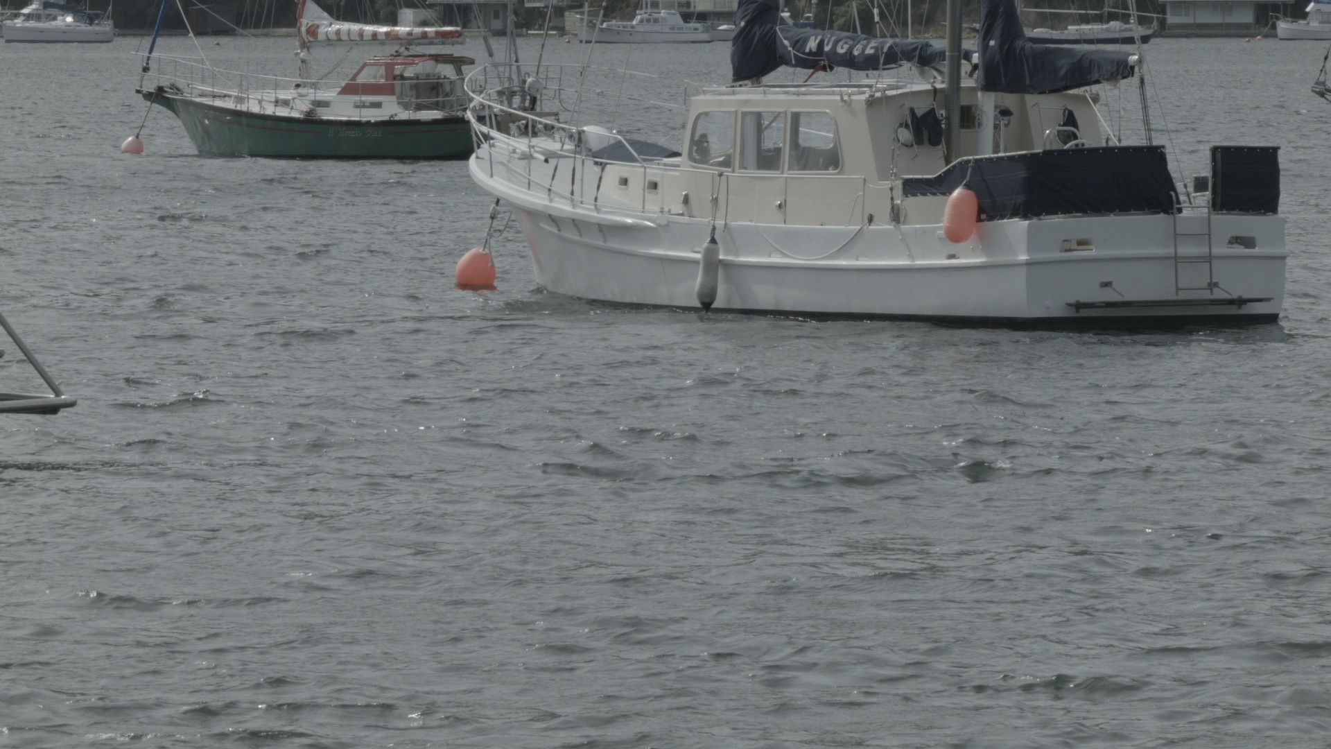

And this took a little longer, maybe 45 seconds, but I'm having a slow evening. Vegas Pro 12.
Color...is it me?-nugget-untouched.jpg   Color...is it me?-nugget-grade-01.jpg

Looks like the blacks are crushed a lot loosing all detail so you"ll loose the benefit of 13stops DR. Would be great if there just was a preset you could drop onto the footage from within your NLE that would get it right from the start.

Looks like the blacks are crushed a lot loosing all detail so you"ll loose the benefit of 13stops DR...
You can crush the blacks as much or as little as you like. That's the whole point!
