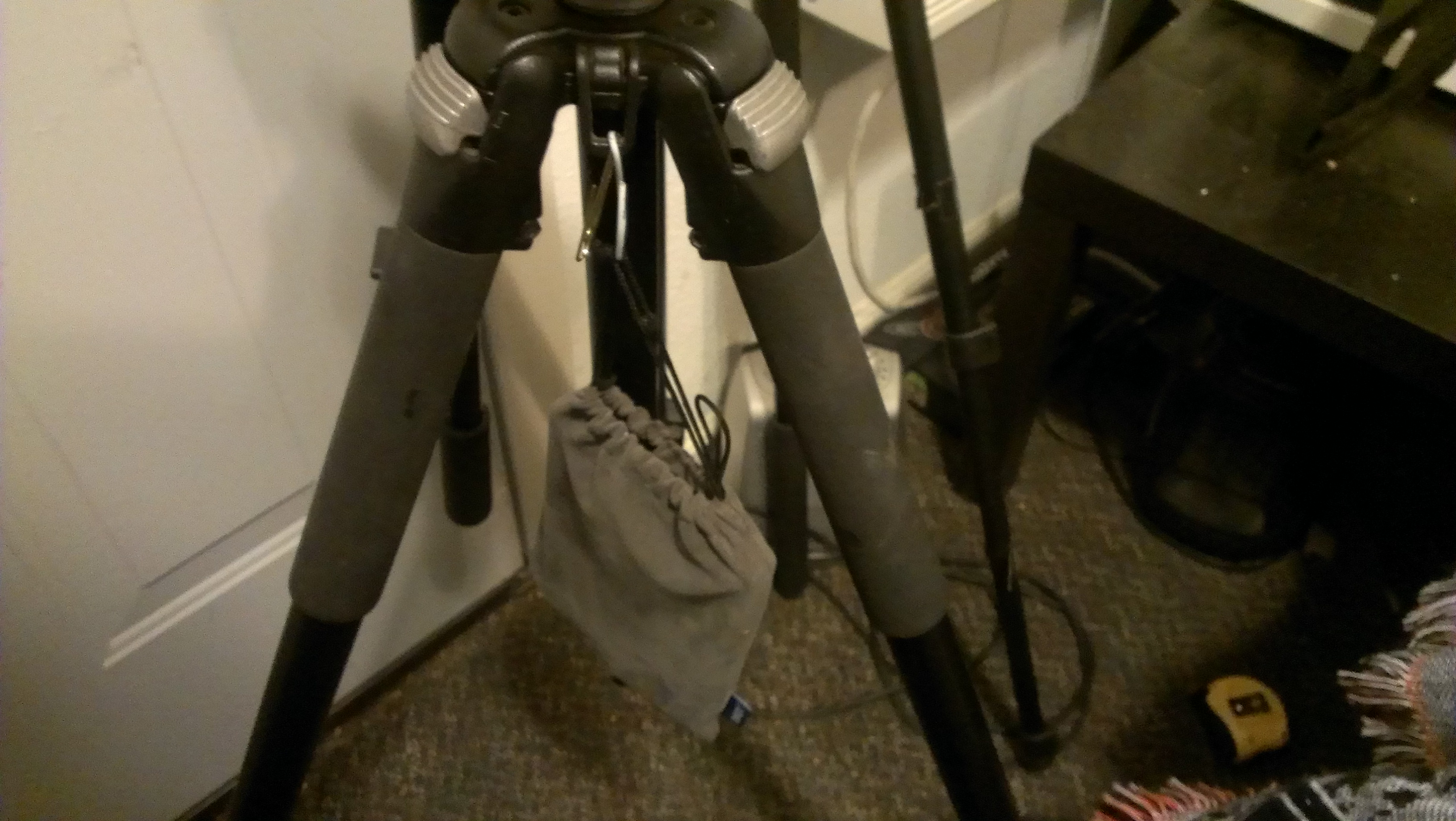

I tend to be DIY on most of my rigging, I am not concerned about looks, just performance. While on a tripod, I hand the Anker from a hook on the tripod, in a bag that came with the Anker.

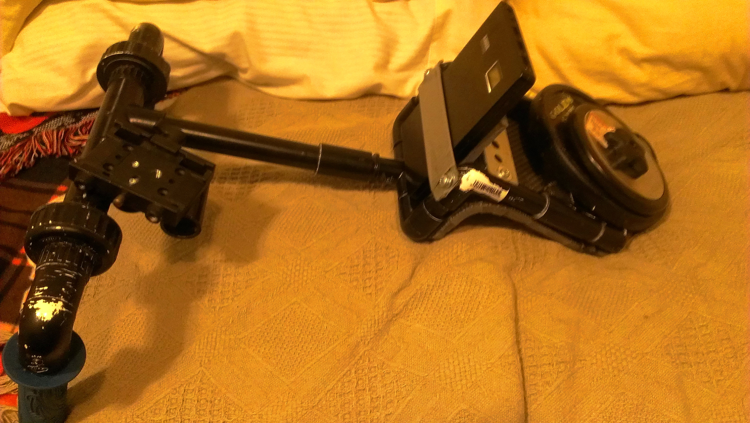

For shoulder shooting, I have devised a should rig, on which I mount the battery.
For shoulder shooting, I have devised a should rig, on which I mount the battery. See pics attached.
