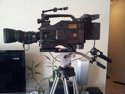

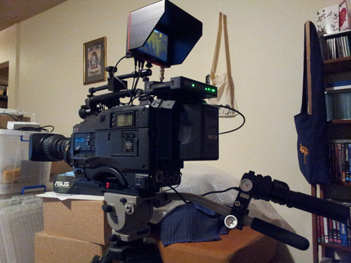

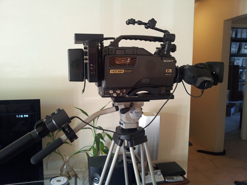

Shuttle on F900.
Paul Kapp is offline   Reply With Quote
