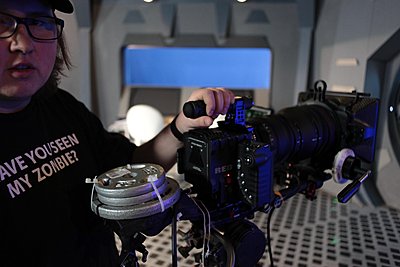

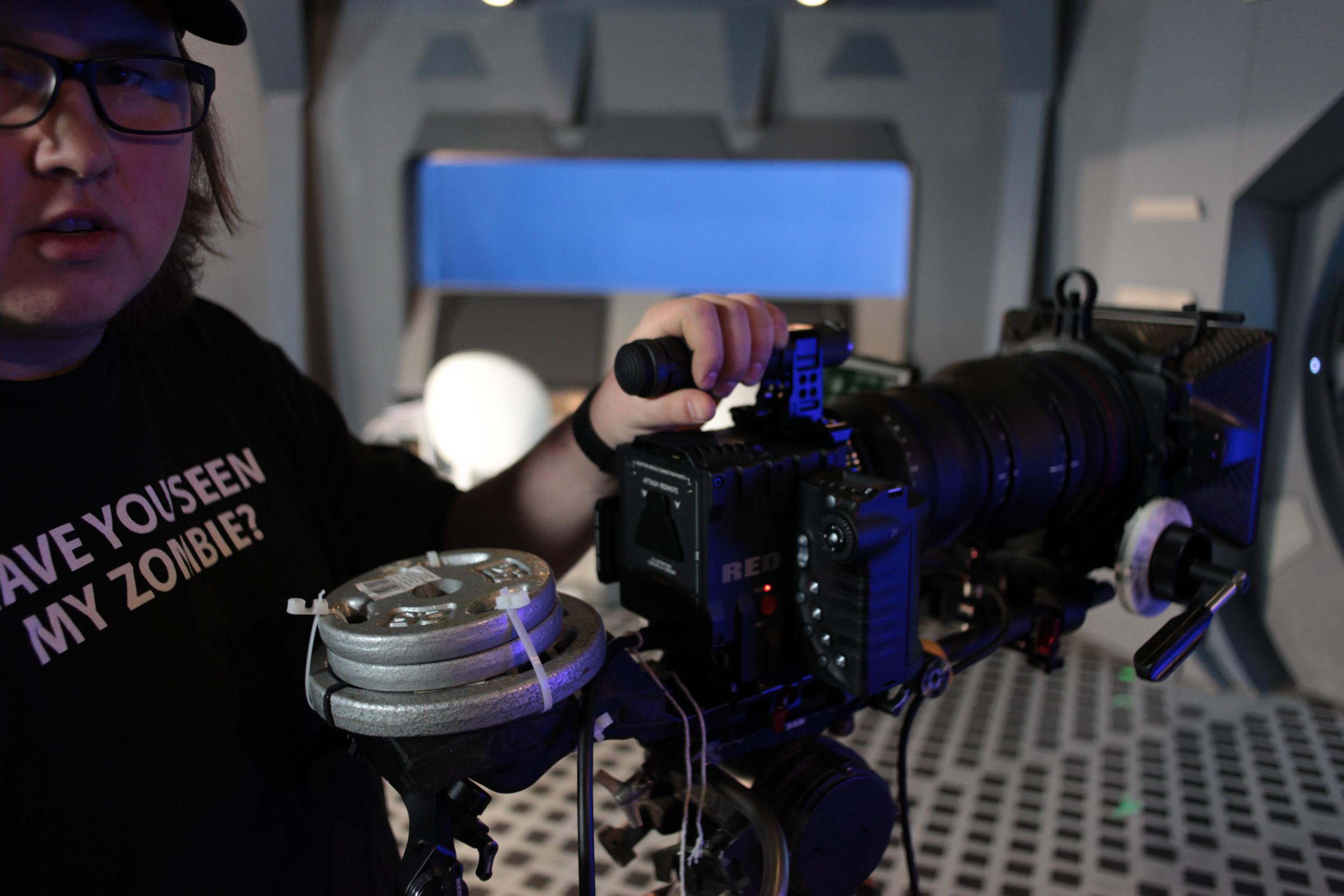

I just spent a week pulling focus on an Epic for the first time. I can't compare the Scarlet yet but here's some first thoughts on the Epic. We were in studio and are heading outside next week.
The two things that jumped out at me were power consumption, media cost, and workflow.
Firstly the Epic is Power Mad - literally... this thing eats batteries. If Scarlet is anything close, you either better plug it in or buy extra,batteries
Media cost - at 5k and 5:1 compression we got about 30 mins on a 128gb card. We rotated 4 of them. I don't like reformatting non-replaceable media when it's not that critical, never mind critical stuff. We re-formatted the SSD daily. That is a little scary to me. The 128gb SSD are 1,800.00 each. So we were re-formatting about 7,500 worth of media daily. The Scarlet production package ships with 1-64gb SSD. You will definitely need to upgrade. Depending on compression rate - it's about 3.5k for an hour of media.
We shot with the Red 18-85 t2.9 lens, which is a beast at about 12 pounds. Set-ups were really slow. This wouldn't be an issue with Scarlet.
The Epic doesn't yet have in-cam playback (although any day now) and we had to review by pulling media and plugging into the proprietary Mag reader. I'm not even sure what that costs.
Basically, the Scarlet production package might list at 15k, but you will definitely need to add at least 5k more in basic upgrades, plus glass to have a functioning workflow.
You could be still using that lens on a Scarlet, it really depends on the lenses you're using on either the Epic or the Scarlet. Likewise you could mount this lens on a PL mount C300.
Old November 19th, 2011, 03:55 PM   #14
Posts: 1,200
Re: Reasons to go for C300 over RED Scarlet X?
Yes...but why. It is a freaking beast.
Our Canon mount was ordered in August and is still not shipped. Supposed to be here next week. We had to add 10 pounds of counterweight to the back to try to balance it a little.
And yes... that is a carbon fibre matte box on the front. Kind of like eating a 3,000 calorie meal, but drinking a diet coke with it. :P

It's a cine zoom lens, with all the mechanical advantages over a stills lens when shooting films. These lenses are all about that weight
You need to rig it using the support bars and a bridge plate that the camera/len combo balances, in this case more or less somewhere under the lens. It's a set up you'll find when small cameras are used with the larger lenses. This arrangement commonly also happens with 2/3" TV cameras using very large zoom range lenses which are often fitted for sports coverage.
When properly rigged you can easily move the combined camera and zoom lens as one unit to the next camera set up.
