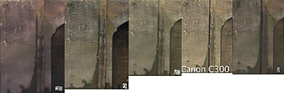

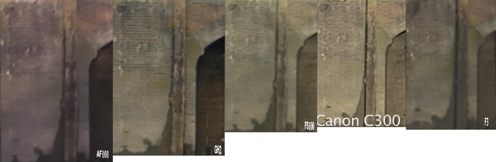

The only thing it can be easily compared with in these examples is the AF101 (as the same size sensor) and it may be surprising to see just how much better it is than that. (You may like to add AF101/GH2 screengrabs to your examples, Sanjin?)
GH2 appears to have more rez than the AF101 judging from these stills...
Phil Bloom's trip to France w/C300-cropped.jpg
