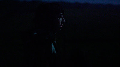

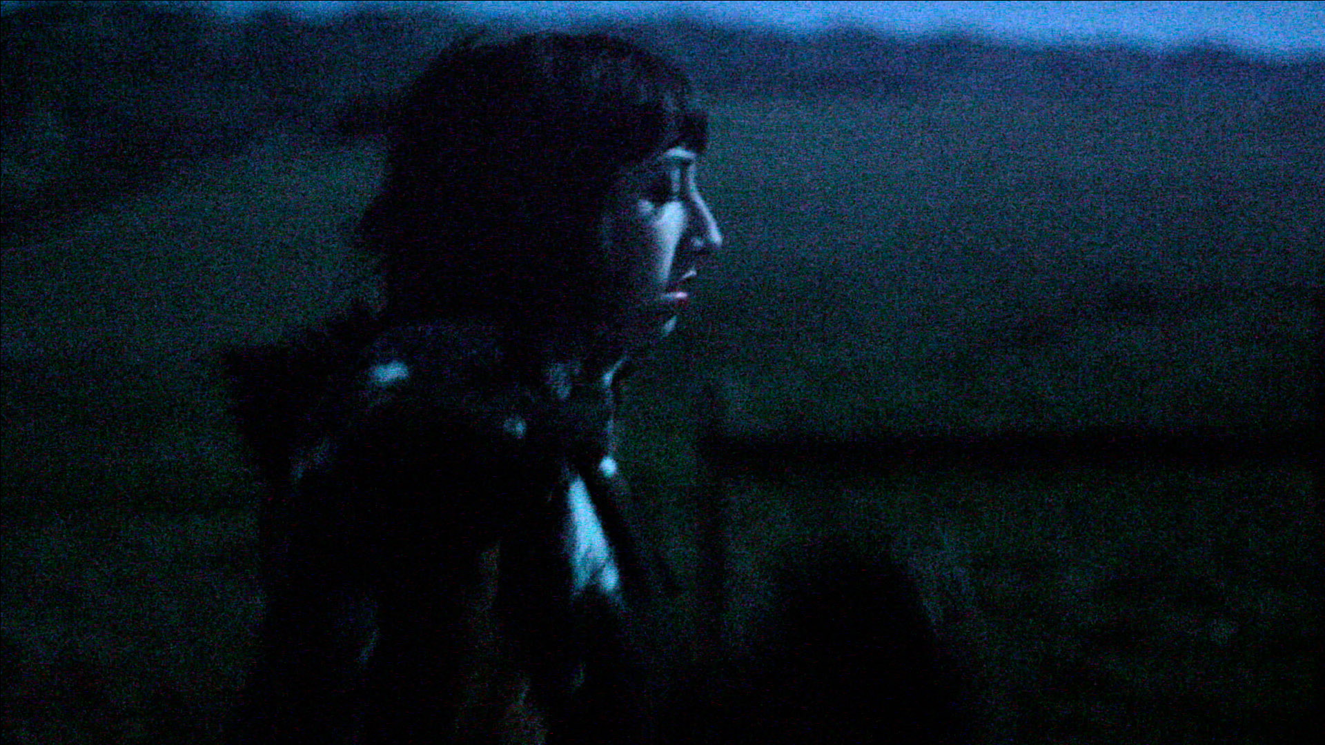

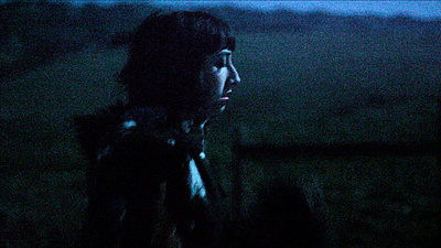

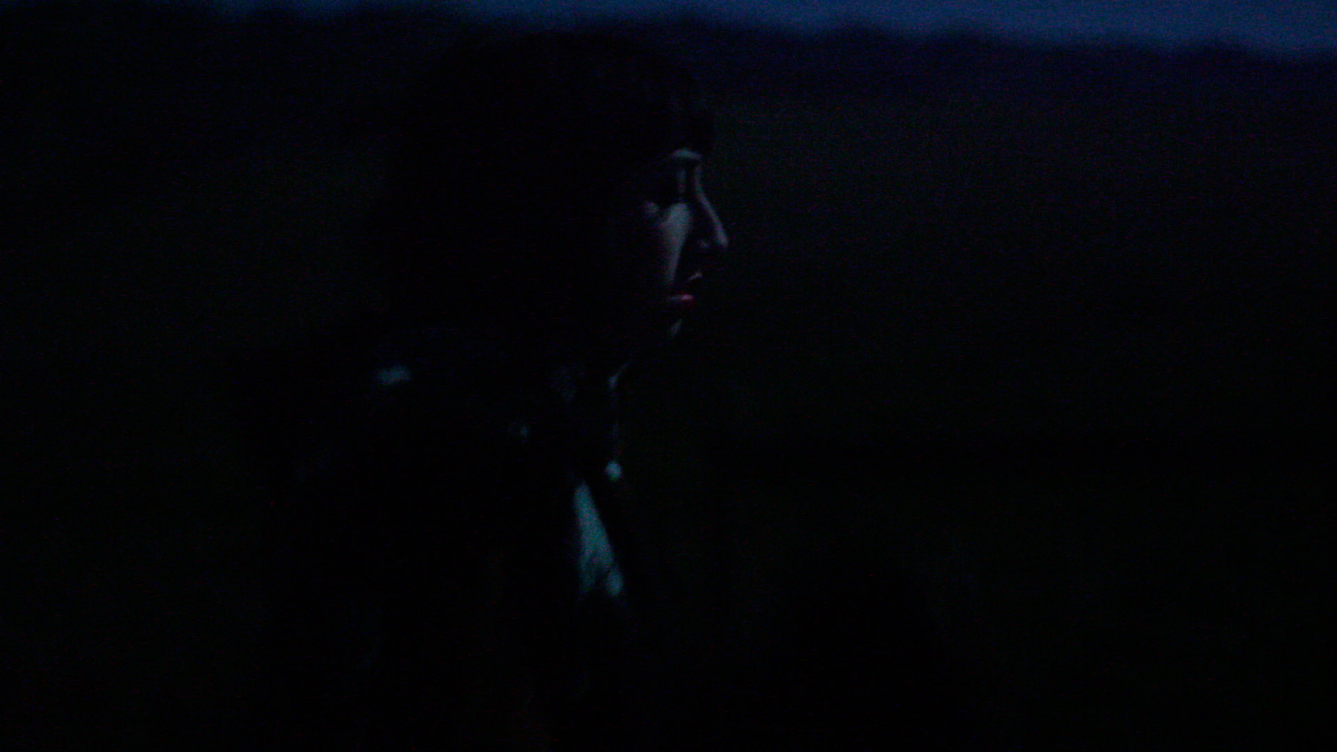

here's a particularly ugly example, but I think exemplative (is that word?) of the dynamic range the c300. This is absolutely worst case I think. ISO 20,000 using the normal 1 setting. Moonlight at f1.4. the original file and then and extreme grade. (I've blurred the image slightly to eliminate some of the artifacts that come up at 20,000. I know this is a noise bomb (see it running though and it's not beyond the realm), but no camera should have this deep of a bottom end (and by the way...most of the original footage in BTLOTM looks much better than this...it's amazing what a half stop of lens and a better camera angle can do for you when your light level is this low).
