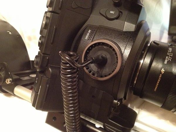

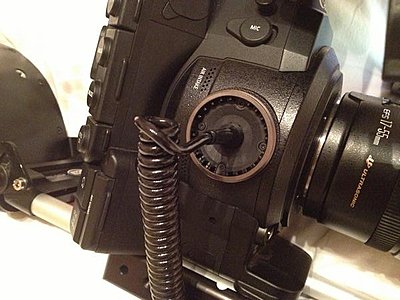

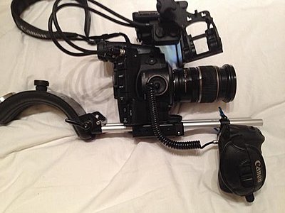

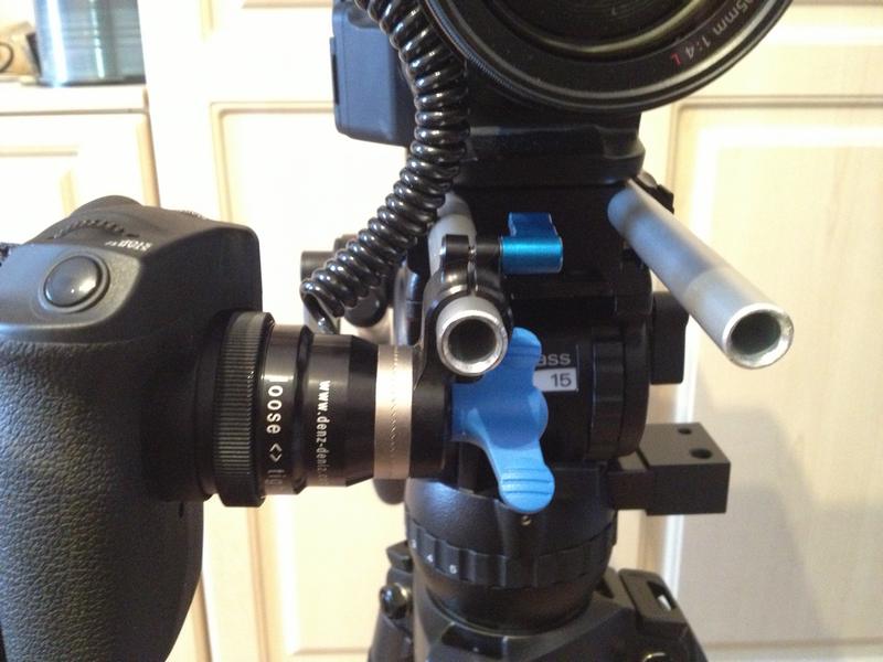

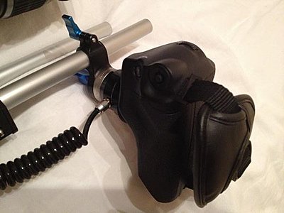

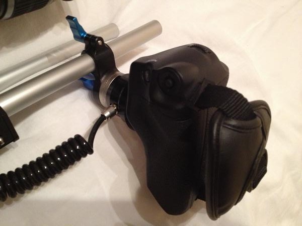

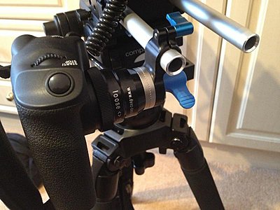

Last week I got the Denz hand grip re-locator delivered.
It feels like a good quality product and I had the chance to use it on friday when I ditched my normal run & gun camera the XF300 for the C300.
The thing I like about the XF300 is where the hand grip is mounted and when used in conjunction with a Vocas rail system it feels good on the shoulder.
The C300 in contrast feels awkward on the shoulder, but with the Denz relocator it feels much better.

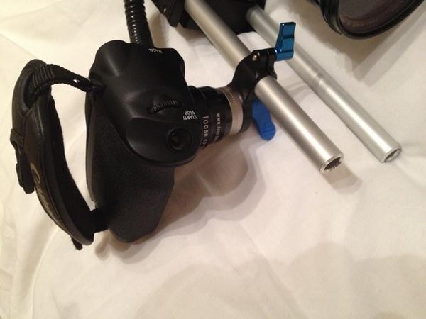

The Denz kit comes in two parts which you have to purchase separately. The re-locator and the attachment which lets you connect it to the rails.

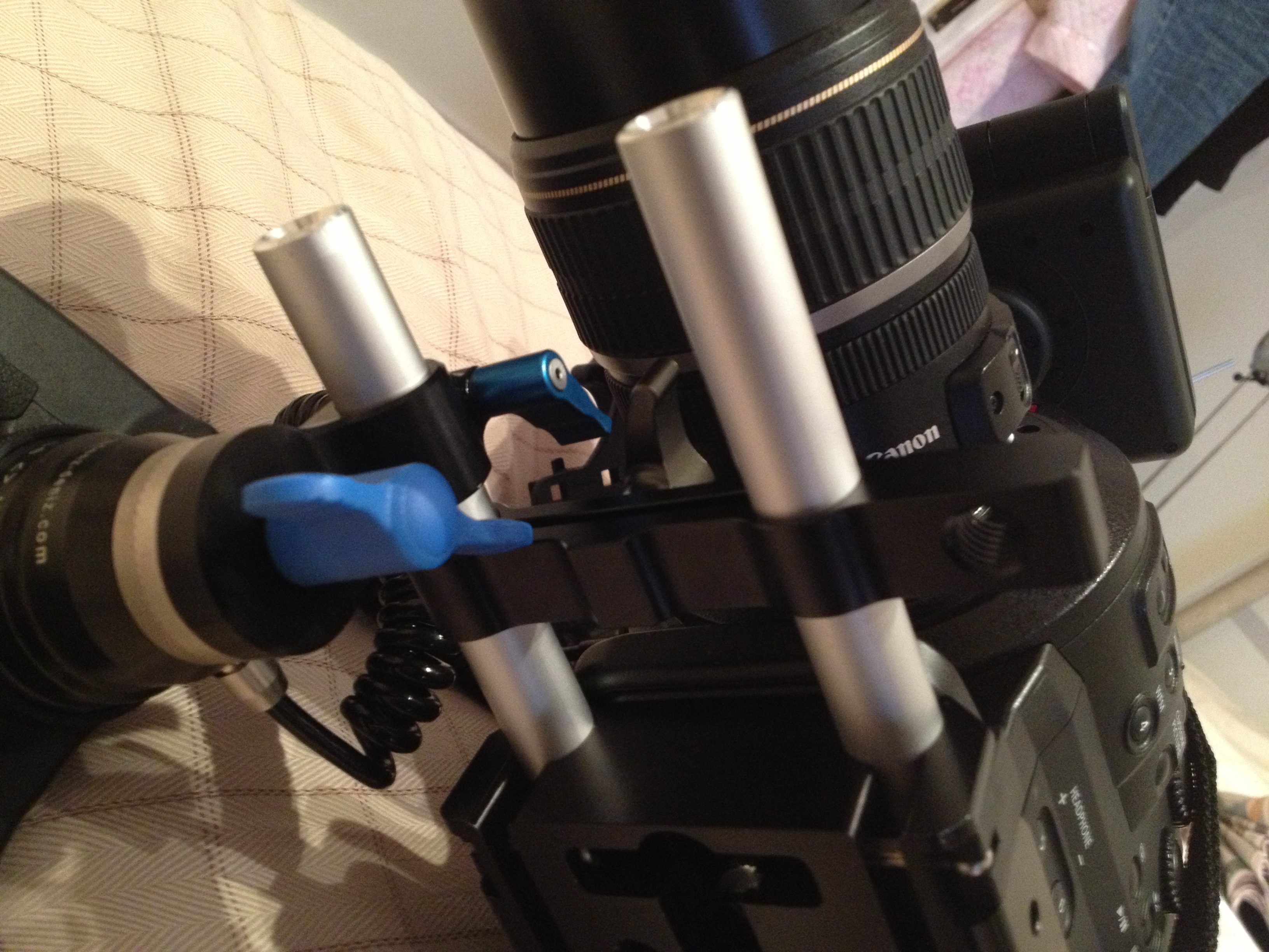

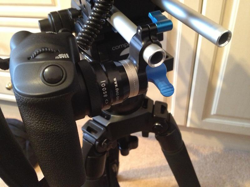

The big problem is that the attachment keeps moving around the the rail. No matter how much I tightened it, it would just move around and if I didn't have the shoulder mount attached to the rear of the rails, the rail itself would move around as well.
It got so bad that I just took it off.
What it needs is a longer bracket attachment that locks into both rails to reduce slippage.

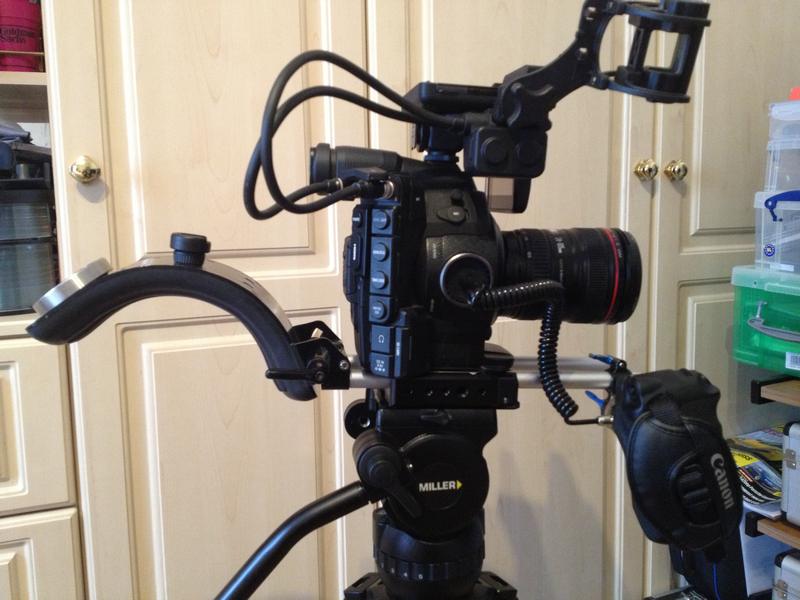

The other problem, albeit minor, is that when using a manfrotto tripod it's a little awkward getting the camera attached to the tripod head as it knocks into the re-locator. Not a problem with the Miller tripods though.
Does anyone know how I can get that relocator to lock in one position? Having spent £££'s, I really don't want to buy another one.
Pics below.

If its always going to be used in the same position by yourself you could simply drill a little hole say 3mm through the curved back of the locator through into the rail and place a 3mm bolt or pin in it, the twisting action would be enough to lock it in place but still be easily removable for breaking it down again. Same where the rail goes through the camera plate. All you need is a drill and a 3mm "metal" drill bit, aluminium is very easy to drill.

Found out what the main problem is and thanks to Mathias for pointing me in the right direction.
The problem is actually with the Vocas base plate. It's not gripping the rod securely as it only has one clip securing it.
Need another base plate that really grips the rod. Once that's done, I'll be using the Denz re-locator a lot more!!
Apologies for posting the wrong assumption.

Finally fixed the revolving rods problem.
Instead if buying a new expensive base plate, picked up a 15mm bracket from Lanparte. No more moving rod and I can use it as an ENG camera.
