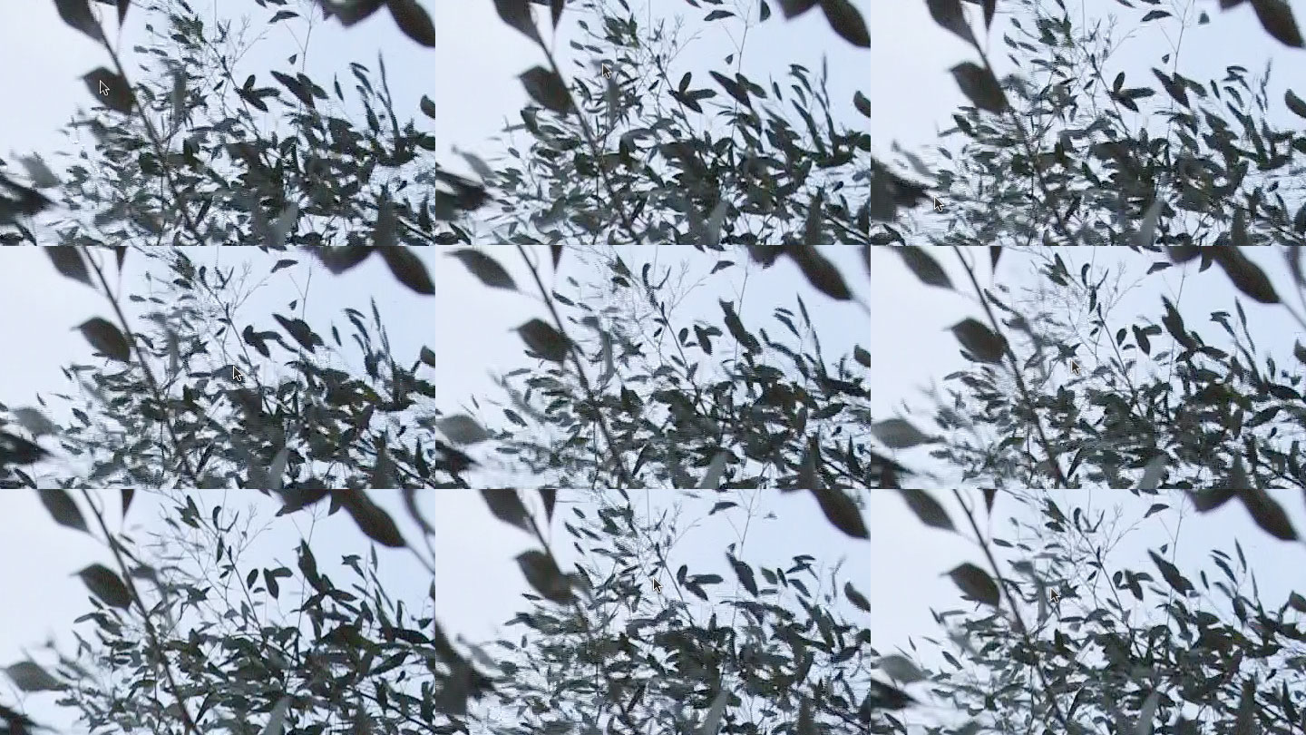

Update: just tried the 'trees in wind' torture test on C100.
For an inter-frame (e.g. Long-GoP) codec, this is horrible: unpredictable motion, every part of the screen contains motion, lots of edges. We'd expect any Long-GoP codec to fall apart here.
However, my first pass at this test is that the Canon's AVCHD isn't quite as robust as the FS100.
Doing simple pan tests is one thing - and in most cases this is the sort of pixel torture we experience with cameras - pixels become blurred, motion is constant and going in a predictable vector. So, the sort of run-of-the-mill motion we get is handled well by the internal codec of both the FS100 and the C100.
However, the 'trees' test is awful. Unpredictable vectors, lots of edges, etc - nightmare.
The FS100 does do a fair job of this - if you pixel peep, you're going to see some mess, but it's fairly innocuous - the eye is very forgiving of it when you play back in real time.
However - and these are preliminary results and just FYI - I'm seeing big huge gobs of nasty artifacts which include partially interlaced mouse-teeth on the C100 footage. Okay, so an ordinary, sane, well balanced human would have a hard time seeing it, but I can - and obsess about such things.
Seriously, the difference between this and the FS100 is enough for me to use an external recorder for anything that features dust, smoke, water, extreme action, big crowds and detailed external wides. Will so a side by side when I'm done with the next assignment.

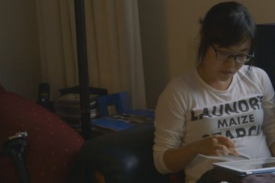

Old August 23rd, 2013, 11:01 PM   #21
Join Date: Jun 2013
Location: Santa Cruz, California
Posts: 33
Re: C100 Ninja vs Internal test 1
The ladies' sweater is more red with the Ninja. This is also compressed. I'm drinking a good Merlot but I'm sure the sweater is more red. With the Ninja she looks more intelligent, less threatening, more of the marrying kind but with the internal... she may be a husband killer. I would watch out. I wouldn't marry this women quite yet. Perhaps another camera might help explain this mysterious aura better-
