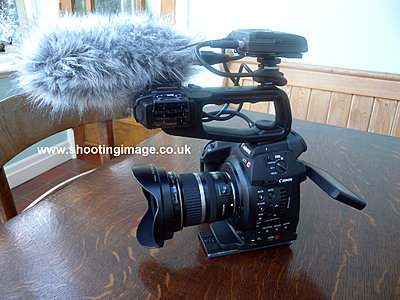

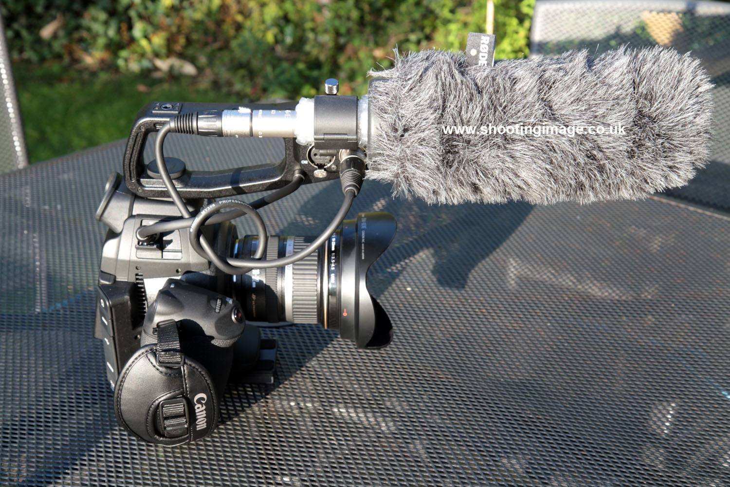

C100: With Rode NTG3 & WS7 Plus Canon 10-22mm Lens
Just a FYI everybody.
I tried packing the mic mount on the C100 with foam and put the Rode NTG-3 on it, in a Rode WS7 windshield. With the Canon 10-22mm EF-S lens, the dead cat/windshield is well into frame top-right, even with the NTG-3 slid further back than I think it should be in the Canon mic clamp. With only the Rode foam cover on then it's possible to get it outside the frame when the lens is set at full wide - just! I know you can set a EF-S setting on the C100 that crops the image in a little but I'm suspicious what this slight digital zooming will do to the image quality - until I can find time to check that. If I zoom to about 14mm I can get the windshield out of frame.
It's going to be great getting highly detailed/sharp images with this ultra wide angle on the C100....:-)
Going forward, I think I will probably either buy a shorter mic (NTG-2 maybe), take the handle off and use my Rode Videomic Pro, or more likely just take the C100 mic holder off completely (like I did with my EX3, it's just 2 screws) and then use a spare Rycote Invision Video mount that I have. That will put the mic higher up and out of frame (as well as being an excellent/superior lyre suspension based shock mount). However, it of course means I that would not be able to easily use the front shoe for anything else. My Sennheiser G2 series radio mic receiver will probably get mounted via the screw attachment on the back handle anyway but I'd like to leave that position clear for a future Ninja 2 - if I eventually decide I really need that.

I have the NTG-2 and it doesnt show up on my 16-35L. I am a little disappointed that I have to pretty much smash the foam in order to have the clamp the mic in

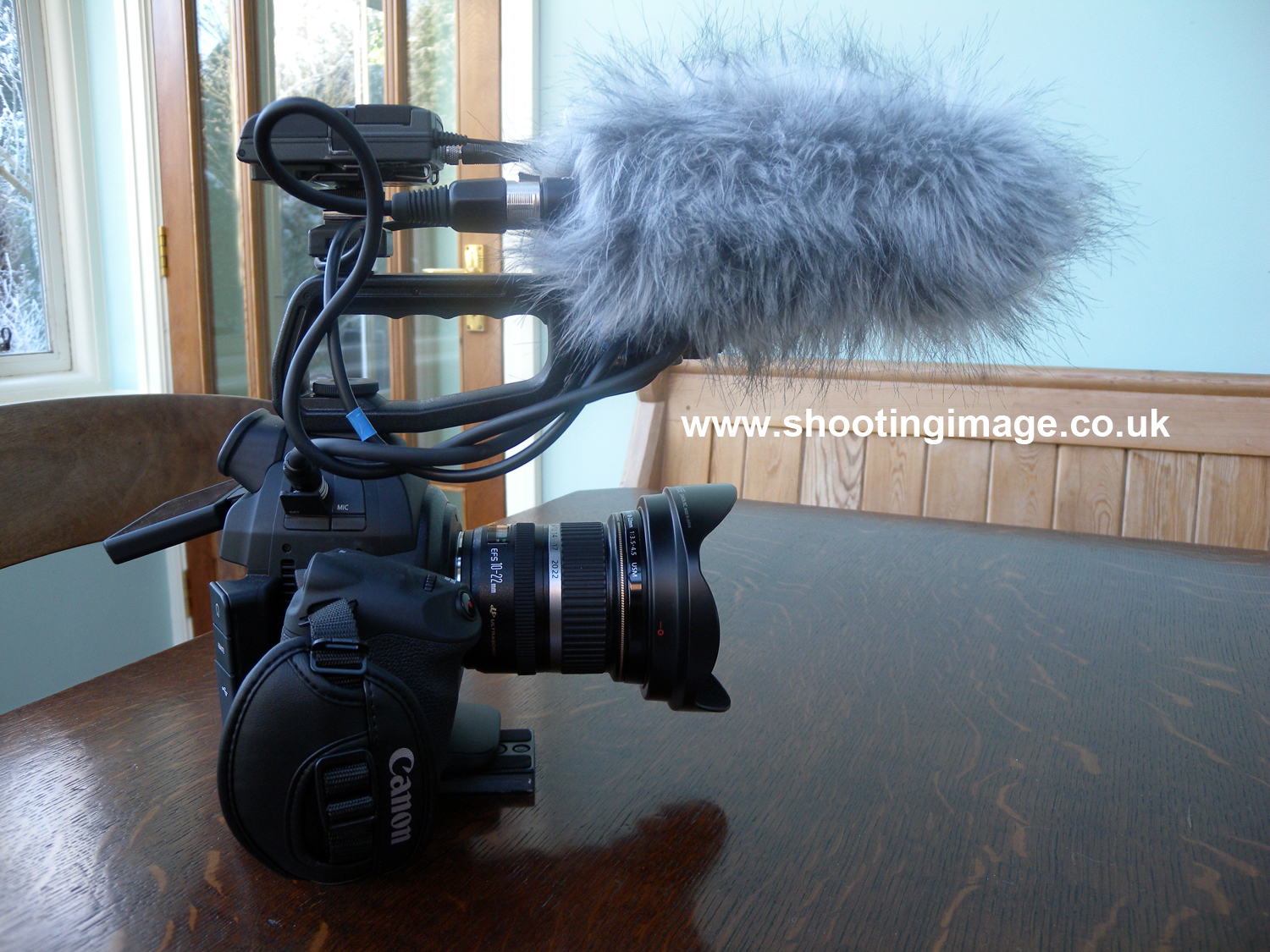

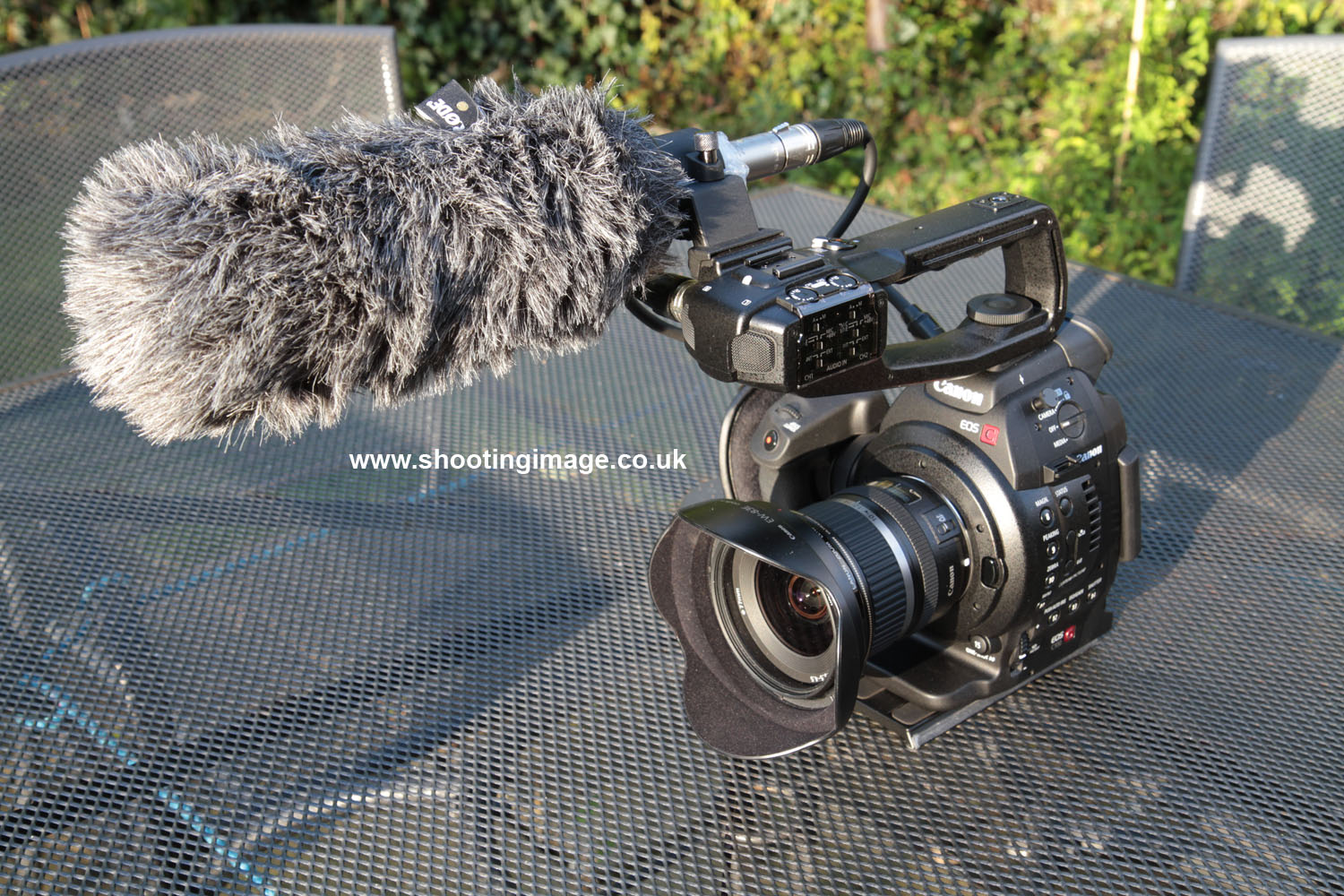

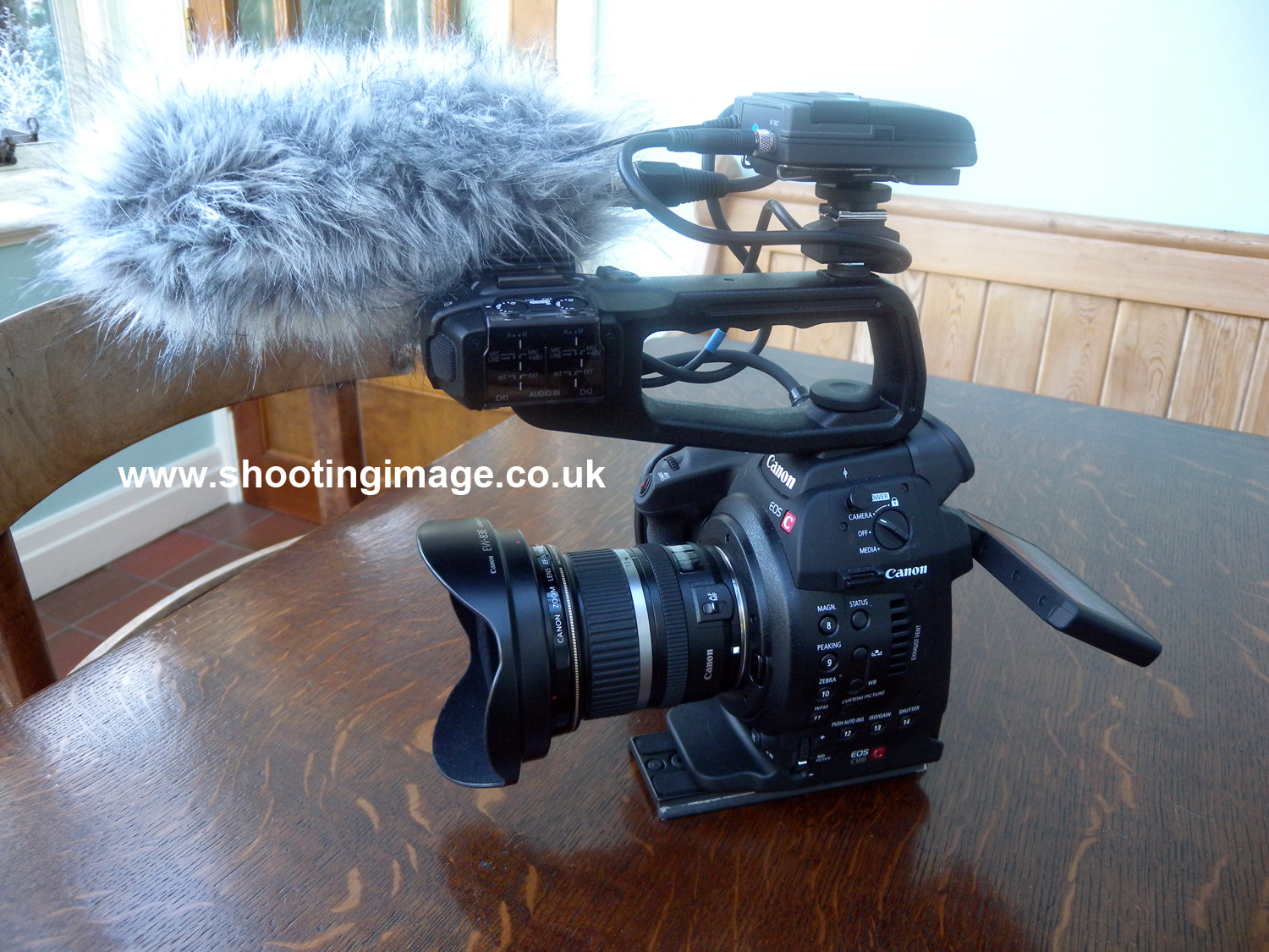

Here are some quick snaps of the set-up. Note that I've just got the NTG-3 quickly packed into the C100 mic clamp with bubble wrap as a very temp measure! Also note that the NTG-3 has been "pushed back" in the clamp as far as I'd dare go to try and keep it out of frame when the WS7 is on. I'd rather it was about an inch further forward (as that's how I usually use it on my EX3) as that ensures all the vents are within the assembly and unblocked by the end collar of the WS7.
Gives everyone an idea of just how far forward the end of windshield is!!!
As mentioned before, with this lens a minimum of about 14mm, maybe 15mm to be safe, is the limit before it all comes into view on the frame - without the EF-S push in digital zoom feature enabled.

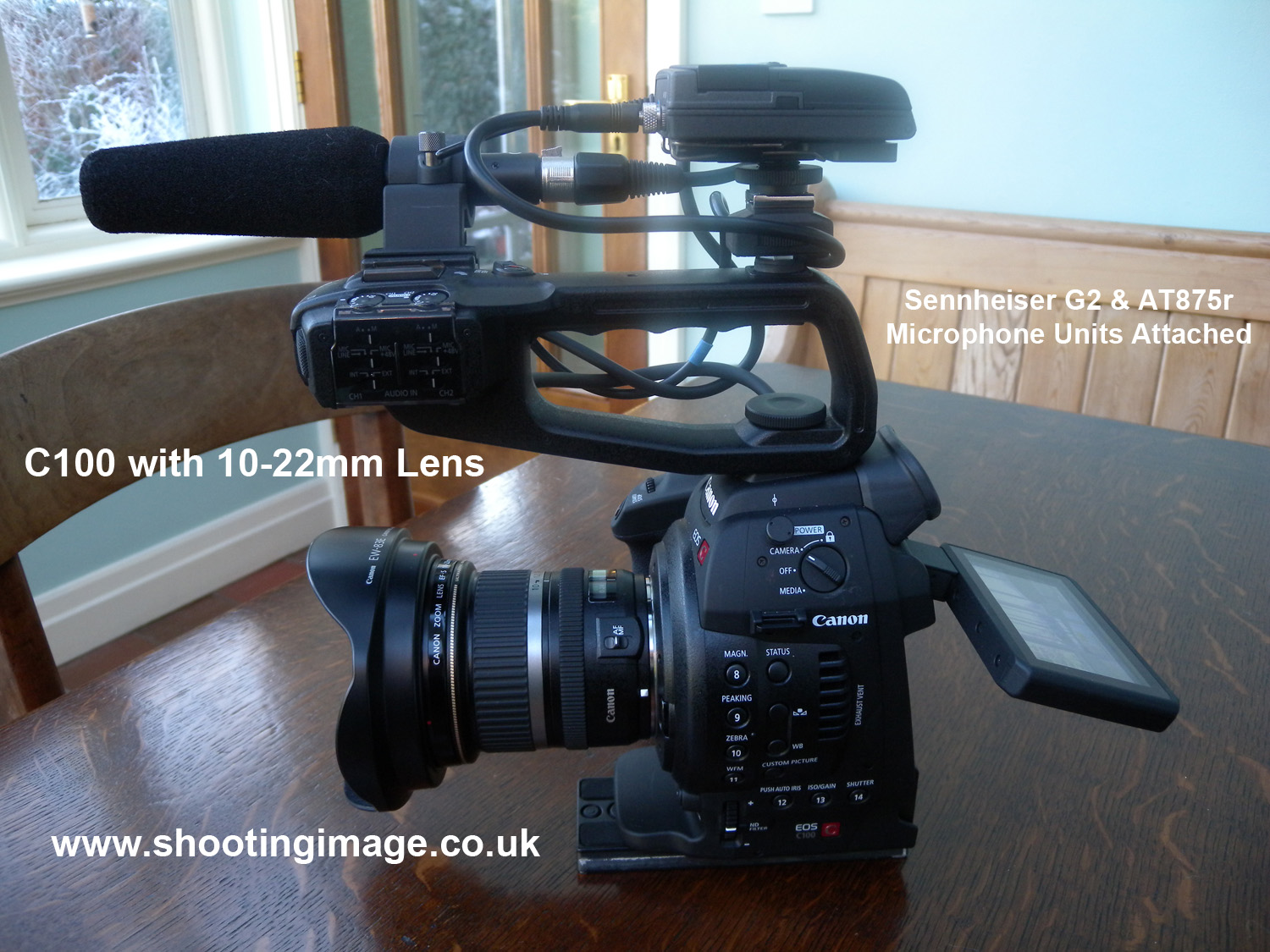

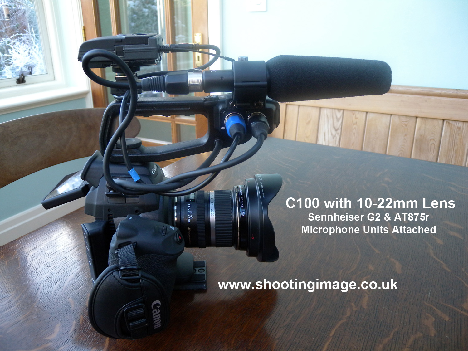

Just to finish this off - here are some snaps of my solution.
This is the Canon C100 with the AT875r shotgun mic - as well as one of my older Senny G2 receivers mounted above the handle. Again, this is with my ultrawide Canon 10-22mm on the camera. Indoor shots as it's blummin cold out there right now!
I've shown the AT875r with and without an old Rode deadcat on it - for now (the one off my original Videomic). That deadcat is a bit overlong for such a short mic and I can just see some hair in the top of frame at full wide. Without this deadcat on there is no problem, even at 10mm. With a better deadcat I'm sure it'll be fine. By the way, I noticed after I'd taken the pics that the mic is about 5mm too far back in the mic clamp - risk of foam rubbing on the clamp making noise - just so you know I know! Gives you an idea of how much shorter this arrangement is anyway.
The AT875r seems to be a very good (and very economical) choice if you need a short shotgun, from both the reviews I've read as well as from my initial experiences with it. It only cost me £100 including delivery from a UK eBay seller, thanks to a tip from a fellow forum member :-)
I've also recently bought a AT4053b, mainly for indoor interview work - that one's a really lovely mic too!

Where did you get the hotshoe adapter on the backside of the handle from?

Peter,
It's not ideal but I needed something quickly. I have to say I was surprised at how difficult it was to find a single item that easily turned the 1/4 threaded hole into a cold shoe position - so it is in fact 2 items, or in truth 3 as there is an old plumbers tap washer in that lot too!
As you can see both were from Amazon UK - but I'm sure you'll find them (or something similar) from reputable US camera suppliers - or even the .com amazon site.
Note that all you really need for a Sennheiser G2 (or G3) reciever is probably the 1/4 inch stud - as that can fit directly into the threaded brass hole in the bottom of the G2's shoe - but it'll be more awkward to line everything up so I went with this idea for now. Also, note that the stud will "bottom out" before the hex nut gets anywhere near the top surface of the C100s threaded hole in the handle.

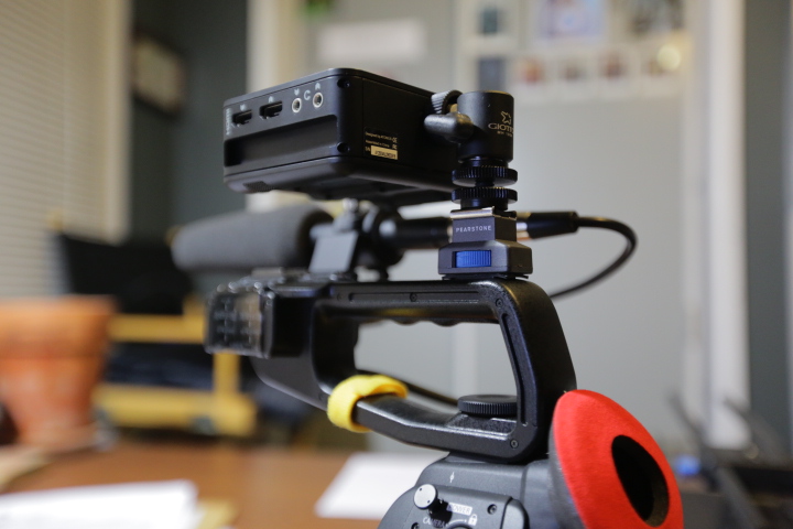

This little guy works just fine: https://secure.bhphotovideo.com/c/se...op+Nav-Search=
Not really optimal for my setup here, but the adapter itself is solid.
