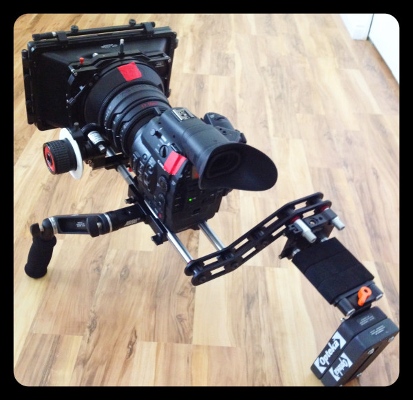

Here's our hybrid Arri/Manfrotto/Optitek rig:
Jeff Regan is offline   Reply With Quote

Re: Best Balanced shoulder rig for C300
Looks like that lines up well with the VF. Does not look like there is much padding on the shoulder support.
How much did that rig cost to set up?
I have tried to get three dealers to get back to me on Movcam pricing and availability and no one is contacting me back. So I have started to look at other options.
