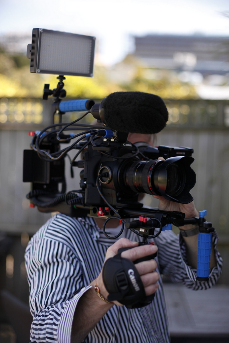

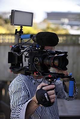

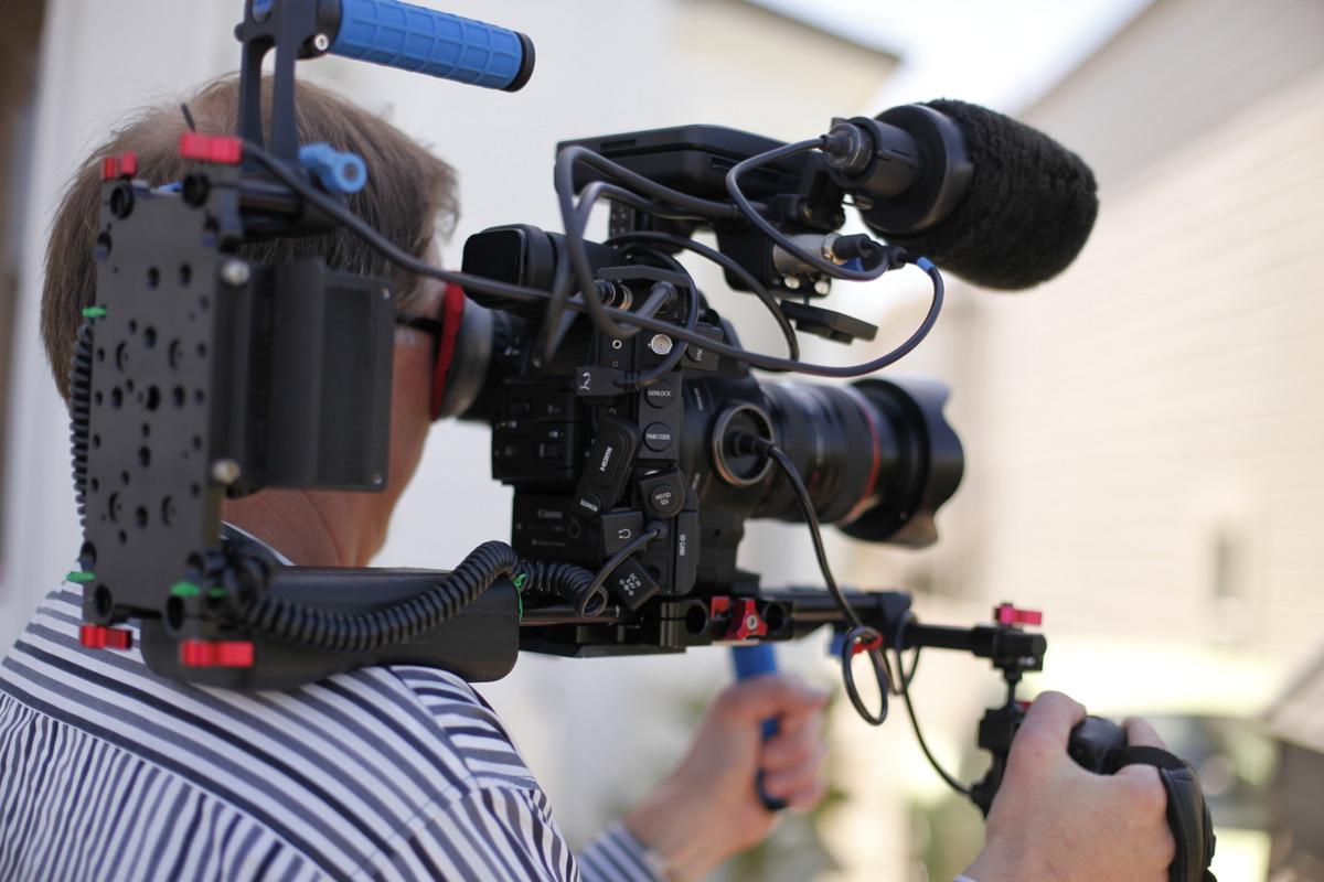

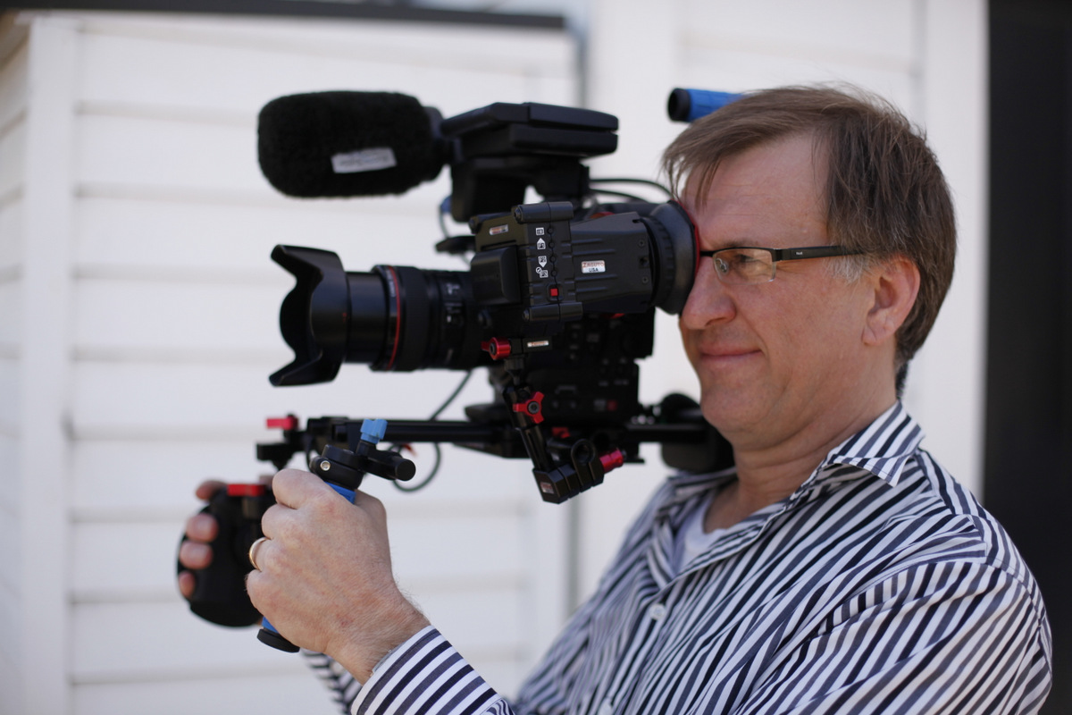

This is our shoulder rig for the Canon C300 camera. Its mainly a Zacuto base plate with rods, with a few Red Rock micro parts thrown in.
The camera sits on the shoulder well for most hand held shooting, and was the closest we could get to a Betacam style form with the parts we had.
Best Balanced shoulder rig for C300-09-_mg_0077.jpg   Best Balanced shoulder rig for C300-12-_mg_0082.jpg

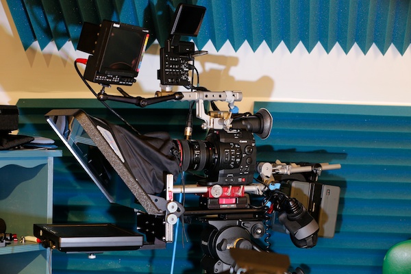

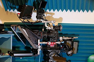

Here is my shoulder rig set up for a narrative shoot in my studio last week.
The Movcam is a nice rig on the shoulder and works great to add on a lot of other gear when on quality sticks.
Hi Paul,
This is an interesting looking rig. Do you have a photo of it on your shoulder without the teleprompter?
What is the model of the silver looking handle on top of the camera?
I did a bit chunk of handholding yesterday with my rig and felt absolutely exhausted by it after 3 hours. I'm used to handholding a Sony PMW 530 with no worries, but I do struggle with the poor ergonomics of this camera.
I did try a Zacuto Stinger kit for my C300, but honestly it weighed a ton. So I stripped it down to basics, but its still front heavy. I do like having an EVF, but have not yet sorted a nice way of mounting it which doesn't involve me fiddling around with it constantly.
Ivars Berzins is offline   Reply With Quote

Hi Ivars,
Agree it is hard to have moved from full size 2/3" proper ergonomics to a camera like the C300. So early in my search I hunted and found the Movcam rig. You can purchase it from two DVinfo.net sponsors, B&H, and 16x9. The top handle, front handles, shoulder mount, dual V-lock battery holder are all Movcam. The bottom plate is 16x9 but designed to be with the system.
I have 20 hand held days since 1 Oct with the setup and have shot 14 hr days with out a problem. Rarely do I use the dual battery or even one battery off the back unless I am in very unstable (on moving boats) conditions and need the extra counter weight. With the two handles and shoulder brace i am very stable and the hands are low enough to not get tired on long days. And getting in tight spots is easy.
I do have a Zacuto C300 handle re-locator and it is great. Sure expensive but it paid for itself the first day. I just ordered the Edelkrone Focus Plus + which will replace my left handle. This will mean I have start/stop, ISO button, iris wheel, all on the right hand and focus on the left hand.
As I said earlier I need to move the camera to the left about 2 1/2" to be lined up properly, you can see this in the picture. I am going to find a rail off set to mount to my 15mm rails on the shoulder support and then the bottom rails to make this happen. Movcam has an adjustment it does not go far enough. There are a lot of options I just need to find the right one today online.
Nice thing is all of this folds down in less then one min and fits in my Think Tank Airport bag as a carry on. Then my Lowe Pro Stealth Reporter has my 5D MKIII with 5 lens and extras so both my filming and still gear come on with me. Rest is checked bags.
Hope this helps?

Originally Posted by Simon Denny View Post
Hi Ivars,
I'm looking at your pictures up top and is that a Zacuto EVF? how do you find this?
cheers
BTW thats not me in the photos its my friend and colleague Stephen. I wear glasses with progressive lenses.
The EVF is Ok, but doesn't really quite focus to my eye, and sometime I struggle to achieve focus with it. Other cameramen really quite like it though.
My biggest gripe is the mounting system. I'm used to being able to swivel the vf to wherever I need it fast. I spend a lot of time fiddling with the articulated controls to get it in a reasonable spot but its never quite good enough or quick enough for my liking.
its a bit uncool to be faffing around trying to get the vf in the right place to operate from.
I have been checking out a Solid Camera EVF support online, it looks better to me.
Cineroid have a new EVF out and I'm keen to check this out in the flesh.
One of the biggest issues for me working with a modular system away from a big city with pro gear shops, is that I don't get to try things out before I buy, I tend to rely on internet forums instead.
