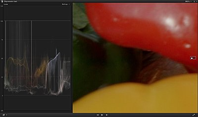

The FS100 has absolutely no problem delivering 1080p25 - truly progressive material cropping up in most NLEs I've used. It could just be 25psf on a 2:2 pulldown, but it's completely invisible to the editor - it just works.
Canon have decided to continue their reputation for malignant PSF (excellent but long and techy article by Allan Tepper here - http://provideocoalition.com/atepper...malignant_psf/), and not only do NLEs misinterpret it, there are odd things happening to the chroma (the 'triangular jaggies' you may have seen in areas of high intensity colour, especially reds):
EX1 x2, C100 --> FCPX & PPro6
