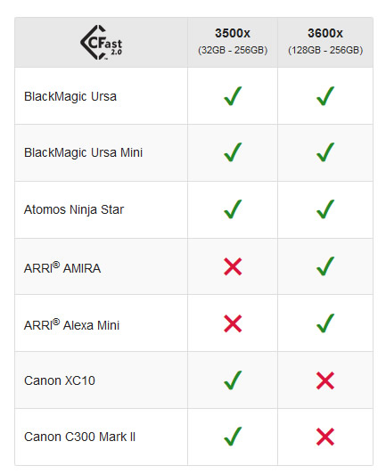

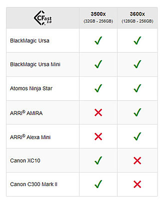

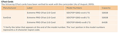

Apparently, the 3600X are not campatible with the C300 mk2.
Only cards that Canon currently approve on their website are the Sandisk.
http://www.canon.co.uk/support/consu...tcm:14-1296998
Although i have been told by a guy at Canon that the mk2 will accept the Lexar 3500X as long as the cameras firmware is up to date.

Using 128gb Lexars myself with no issues. The 3500x variety. Have shot 1080 & 4K.
As Sayeed mentions, the 3600x are apparently optimised for Arri. Hope those cards work okay for you Scott.

Canon recently officially approved the Lexar CFast 3500x for use with the C300mkii and XC10 but not the Lexar 3400x or 3600x. You can see it on Canon's C300mkii product page near the top of "features".
