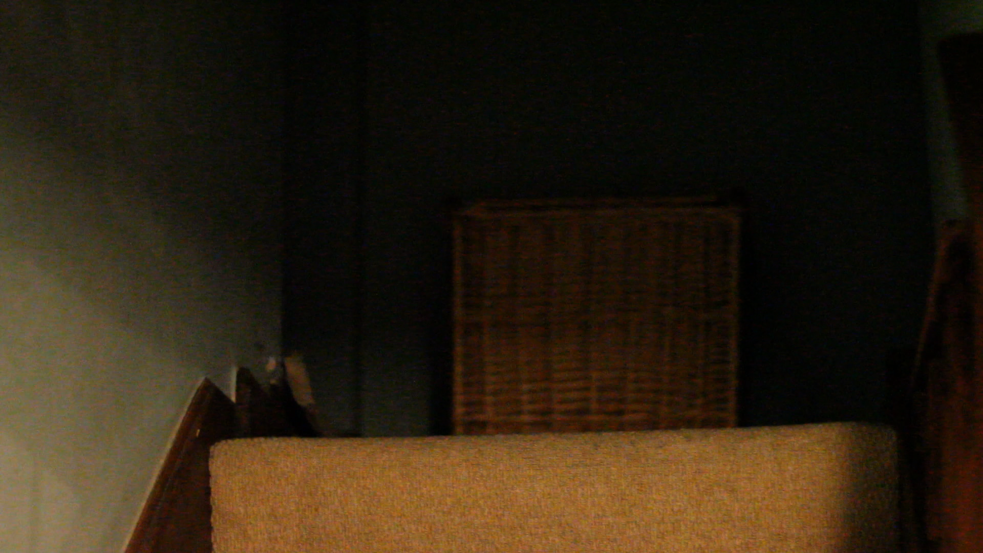

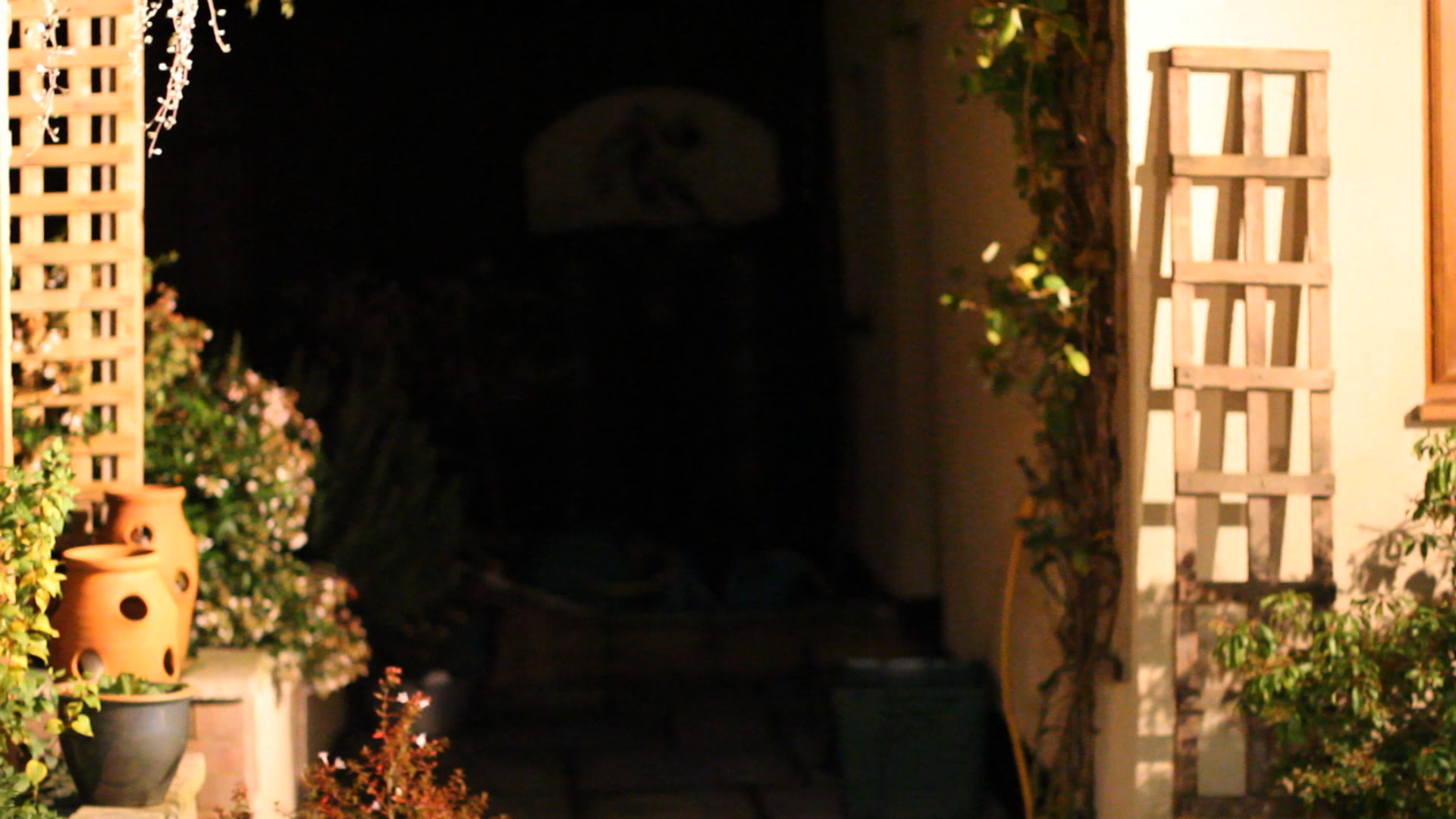

If you do still end with some noise you can use neat videos plugin for FCP (Neat Video - best noise reduction for digital video). As a test, I just stuck the 7D in full auto mode (with manual focus) and walked around outside at night, in the house etc. The clips below are not in focus or exposed correctly but do show the effect that the neat video plugin can have. When in focus and correctly exposed the effect is amazing with very little softening of the picture. The two stairs pictures are focused on the carpet on the top stairs. Again, none of these shots are inspiring. I purposely sought out bad in order to see the limits of the camera and how well things could be rescued from a worse case scenario.
7D video : big pixel in low light ! ISO ? or ...-mvi_0261-xdcam-noise.png   7D video : big pixel in low light ! ISO ? or ...-mvi_0261-xdcam-filtered.png
7D video : big pixel in low light ! ISO ? or ...-mvi_0261-xdcam-stairs-noise.png   7D video : big pixel in low light ! ISO ? or ...-mvi_0261-xdcam-stair-filtered.png

Neat is a great tool, although it slows my system down about 5X. I've been able to improve good video and salvage lousy video. Very good product. Take some time and shoot samples of different scenarios at different setting in controlled situations then store those filters for future use.
I also am an XHA1 user and I find I have preferences for the 7D or the XHA1 depending on what I'm shooting. I think it's easy to forget that the A1 has great, fast L-glass, so if you compare it with 7D kit glass at f3.5-5.6, you have an uneven playing field. Put an f1.2 or 1.4 on the 7D and it cleans it up substantially, although it still has more noise than I expected (and I'm on my 2nd 7D). Neat really helps clean either camera's footage.
