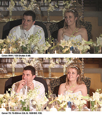

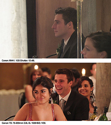

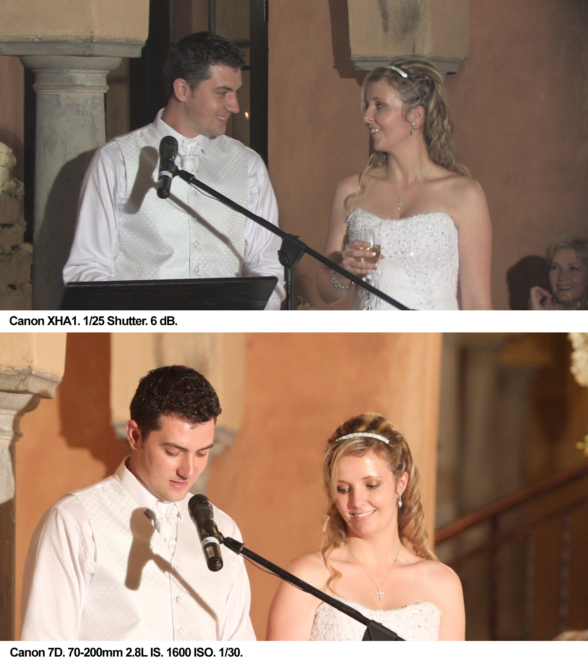

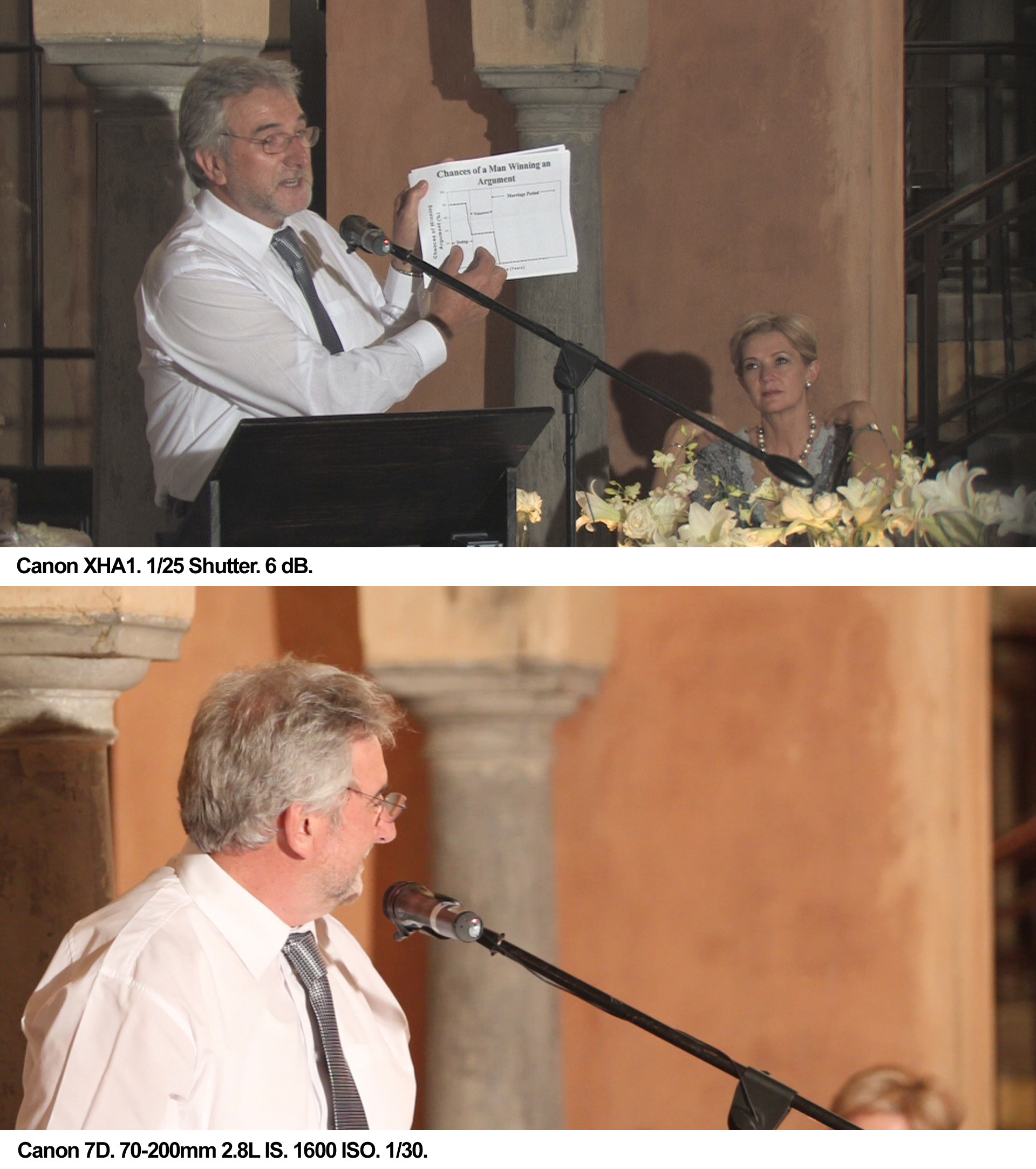

I rented in the 7D over the weekend to shoot along side my Canon XHA1 at a wedding. Here is the results from my low light tests at the reception. In all cases color/noise and brightness looked better on the 7D. My conclusion is that the 7D is definitely a good low light camera for wedding receptions.
No color grading or editing was done to the images.

But the 7D is also showing a good deal higher contrast level. It is blowing our the whites in the video to expose for the faces. The A1 is showing more much more range to work with.
The difference in the flowers between the 2 is staggering. And your not in a high contrast lighting scenario at all.
I shoot with the XL H1S and the 7D together, and I limit the 7D shots to closeup shots.

Michael I agree with you, however this was my first shoot with the 7D. I've noticed it's very hard to judge exposure and easy to over expose shots without Zebra Stripes to help.

I agree with that. But the thing here is your exposure for their faces is within range of where it should be. And the flowers, the guys white shirt, etc. are all blowing out tremendously in a low contrast lighting situation. It shows the limited range the SLR has in relation to the A1.
You should try shooting with the Marvel cine setting that you can download from his site. It lowers the contrast a lot in the 7D. Still not at the level you can get out of the XH/XL but it helps.

I though that Dslrs in general should have a wider dynamic range....not less. I am seeing similar issues with my 7d in situations where the lighting "is" low contrast to start with. And I have already set my contrast as low as it will go. Have to admit it does pull a great image out of not so well lit situations but often times it appears that it has a built in S curve that blows out the whites and crushes the blacks all too easily if you are not careful.

I also agree that the 7D is blowing out detail in the whites.
At least the XH-A1 camcorder is maintaining a lot more detail in the flowers, shirts and face cheeks etc.
The 7D files may look more punchy and vibrant strait from the camera, but the 'duller' XH-A1 files hold far more details and could be worked easier in post to replicate the 7D files...but not the other way round.
The XH-A1 could also be adjusted in presets to deliver more punchy high contrast shots straight from the cam if that is what is required.
