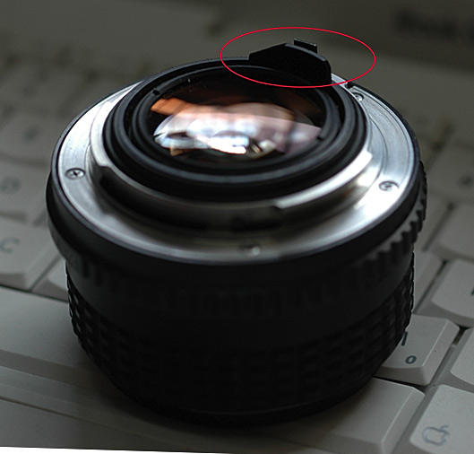

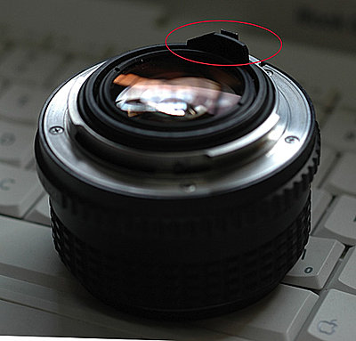

I have a small mechanical adapter for this lens. I was under the impression that the two tabs had to be cut off for it to work. But so far, it doesn't seem to be the case. But I get a message saying "ensure lens is attached by pressing start..." when I turn it on.
Does anyone know if I'm supposed to dremel off these two tabs? Pictured here...

You can use the lens as-is. Physical modifications should only be considered if the lens is interfering with the action of the mirror box. The error message that you see is what happens when you use lenses that don't have electrical contacts. Since the camera can't communicate with the lens, it assumes that no lens is attached.

It's confusing because there seem to be several versions of the 50mm 1.4 Pentax, some of them apparently require tab removal, this one doesn't.
I'm just going to leave the tabs there. If it's not broke don't fix it.

I have the SMC-M 1.4, it's actually my favorite lens for video right now. I'm using a 5D though and did have to cut off the tabs to make it fit - it wouldn't mount at all with them on. I got a cheap adapter from ebay with the focus-confirmation chip, it mounts very securely and I just leave it permanently attached to the lens. Can't really say the chip is important (only matters for stills anyway) - it works, but especially wide open with a lens this fast it's almost impossible not to overshoot focus by the time the confirmation beeps.
