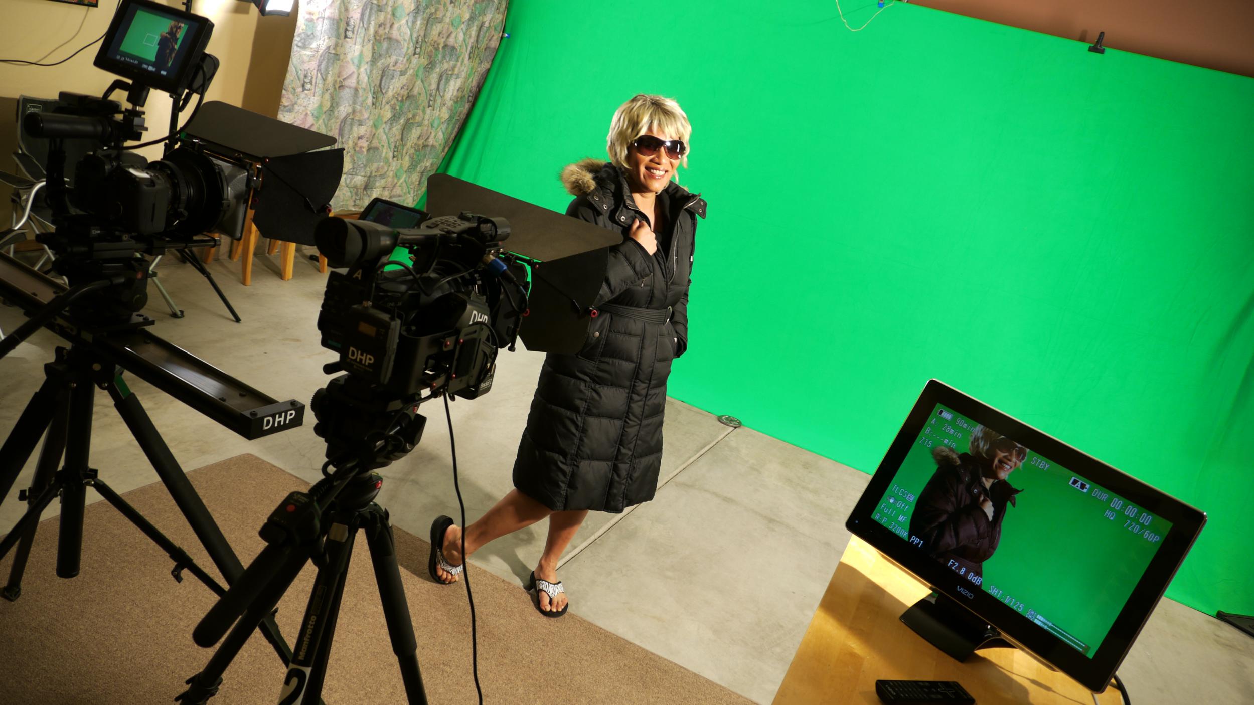

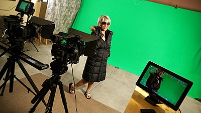

This short 30" was all done with the 7D and ex-1. Most green shots with 7D. Not particular problems with it. Also consider that keying was done with Vegas, without any external plug-ins. I did find easier to get "clean" edges with the ex-1, but 7D was workable as well. I am also attaching a photo of the green screen setup (incomplete - we are getting the floor section of it on thurs).
Carlo Zanella
The Santa Fe TV Show
suitable for green/blue screen shooting?-p1090029.jpg
Carlo Zanella is offline   Reply With Quote

The attached image appears to be a still picture not a frame from the video therefore it tells me nothing about how the video keys.
