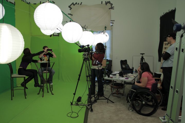

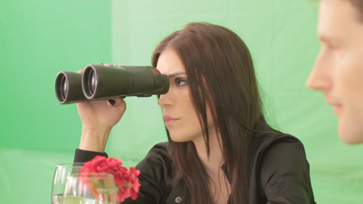

Not much you can do about spill but it's easy to manage in the compositing app. I've been using the 550D the last few days on an all-greenscreen shoot and it appears to be holding up very well. I've attached a photo framegrab from the 550D video and then a picture of the behind-the-scenes setting. As you can see, conditions are far from ideal, but the camera doesn't seem to mind!
Robert, from a compositing perspective, I always try to leave extra room around the actors to allow for a little flexibility in post. You can always zoom in on a shot but it's a little difficult to zoom out.
Jan interesting lighting.
I take it that since it's such a small space that you didn't light the green screen.
So was your solution to use china balls to light both talent and green screen evenly?

I lit it in such a way to raise the ambient light in the entire room. The greenscreen was at about the same fstop as the subjects, and I added a bunch of kickers as needed to create the environmental highlights for each scene. Above all, the intention was to create even, neutral lighting so that there wouldn't be any changes in exposure when walking around the space. In that regard, the setup did succeed. Low-budget doesn't always mean cheap!
