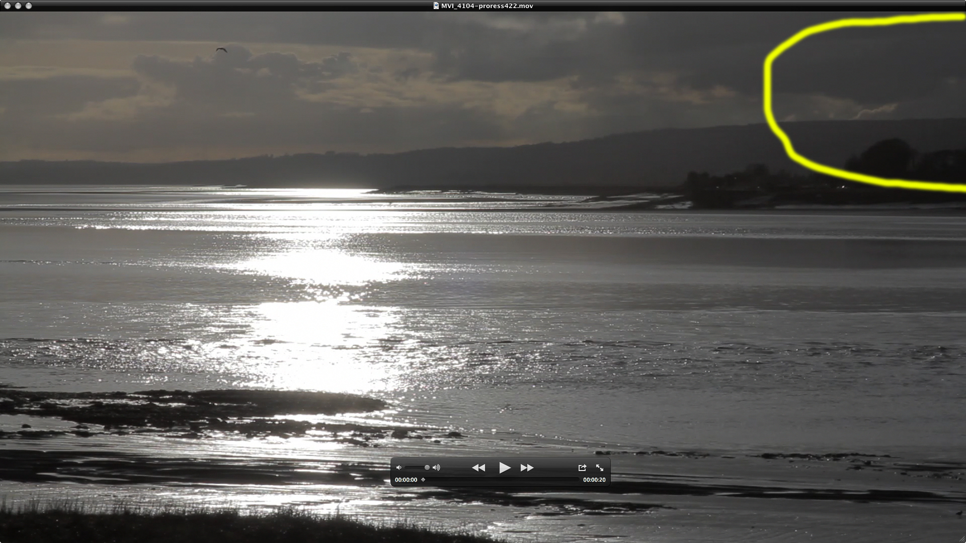

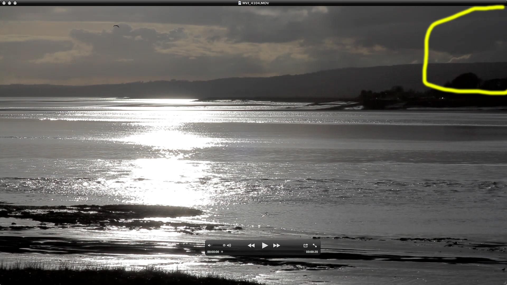

I recently took a pick up shot across a river coming into sun set, sun in front and to left of frame with the 7D. As the shot is to be a composited in background, and I haven't seen the foreground yet, I took a few versions at different exposures, from slightly blown out - balanced - highcontrast dark shot.
This last shot when played through quicktimeX has noticeable (and distracting) blockiness in the top right hand corner, where the picture is gray. Tonal range across this frame goes from white to black and obviously some bit in between.
If the same file is played in Quicktime 7 pro, no blockiness is seen.
It's difficult to compare in FCP, as it struggles to play h.264 clips at full speed.
So, as normal, I convert the H.264 into Prores 422 (LT). Blockiness is still apparent in Quicktime X. I then tried Prores 422 (HQ) and the blockiness is not there in QuicktimeX.
Is this an issue with QuicktimeX or the 7D compressed clips and / or I am I better off transcoding to prores 422 (HQ) ? If I Transcode to 422 (HQ) then transcode that clip to prores 422 (LT) the blockiness returns (in quicktimeX).
I have attached two photos, Sunset-Block.jpg (H.264), and Sunset-422.jpg (Prores 422(HQ)). Both are screen grabs from QuicktimeX.

There used to be a setting in Quicktime 7 (and below) to play the clip at full quality (not on be default?). Window > Show Movie Properties... then select the video track and check the box "High Quality" in the bottom right.
ProRes LT might be compressing it too much? I don't have Studio 3 at the moment to conform. I only have ProRes and HQ and regular ProRes works fine for me.
