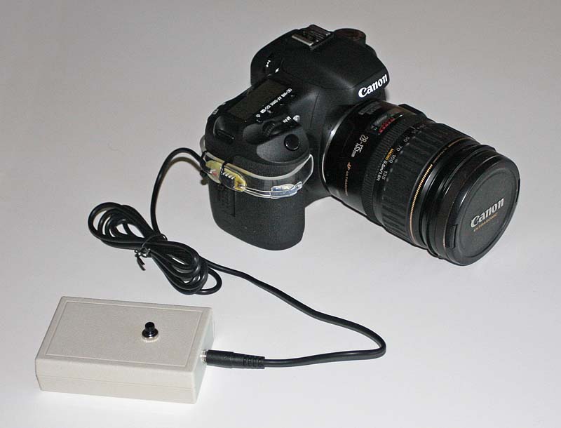

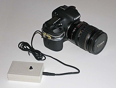

I built a wired remote trigger for the 7D video function. I heat-formed a Plexiglas clip that hugs the camera body and holds an IR emitter in front of the sensor. A cable plugs into a battery box with a push button. It's not elegant, but it works fine. I can put a 20 foot extension cord on it to place the camera in a bush and stand back to wait for hummingbirds.
This sort of thing would lend itself to radio remote too.
I was too cheap to buy the Switronix unit and wasn't keen on the gooseneck emitter they use. This slips on or off quickly and stays put.
