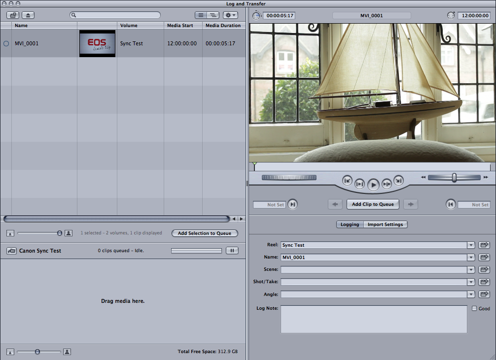

Remember you don't have to make a disk image as Canon instruct, just create a folder called 'DCIM' you can put multiple sub folders in here as long as they contain .MOV and .THM files from the supported cameras. You just eject the folder from the transfer window when you are done.
As for support fro the 550D, would be nice is someone like 'Glue Tools' would produce a small app that would convert the .THM into the correct format. Shame that Canon have yet to support the plugin with a camera that supports the same video formats as the 7D. May be they will.

Here is a generic .THM if you want to test with your 550D. (zipped for integrity)
Date timecode set at 12:00:00
