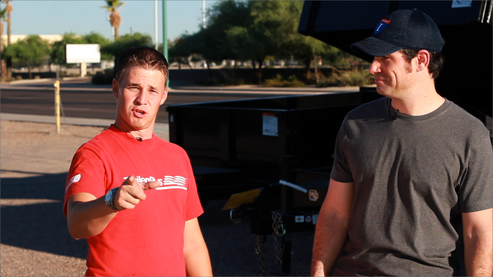

Just curious about the shutter speed question. I'm not an expert so I may be doing something wrong but for video on my T2i (soon to be replaced with a 7D) I have always used a low ISO (100 or 200) and changed the aperture to get my desired DOF and then adjusted exposure with the shutter. Yesterday I did an outdoor shoot in full sunlight and with my 50mm 1.4 I used ISO 100, f5.6, and the shutter speeds were cranked up in the 1/800 - 1/2000 range. The video looks absolutely flawless to me.
Is there something technically/mechanically wrong with that or is the end result what I should be concerned with? Cause I'm blown away with how it looks compared to my HMC150. Just need a little bit of color tweaking.
Here's an untouched screen grab...

Your shutter speed should be double that of your frame rate (or as close to it as you can get). I would be very surprised at a 800 shutter that the video doesn't strobe badly. Like the opening scene of "Saving Private Ryan"

nope no strobing at all. I'm cutting it with vid from the HMC150 and it's working great! I monitor my FCP rig through a Matrox MX02 into a Sony Bravia 32" LCD so I would definitely see issues like that.
for safety in the future, would multiples of the frame rate work? I shoot 30p.
