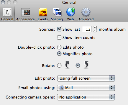

The best way is to get a CF card reader.
And if you don't want Iphoto to launch every time you hook up the camera or insert a card, you can set that in the Iphoto Prefs.
