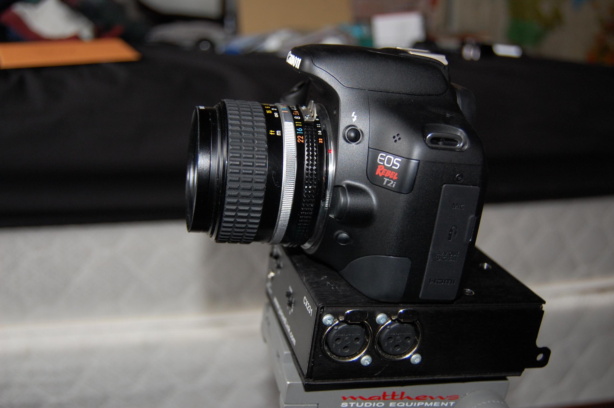

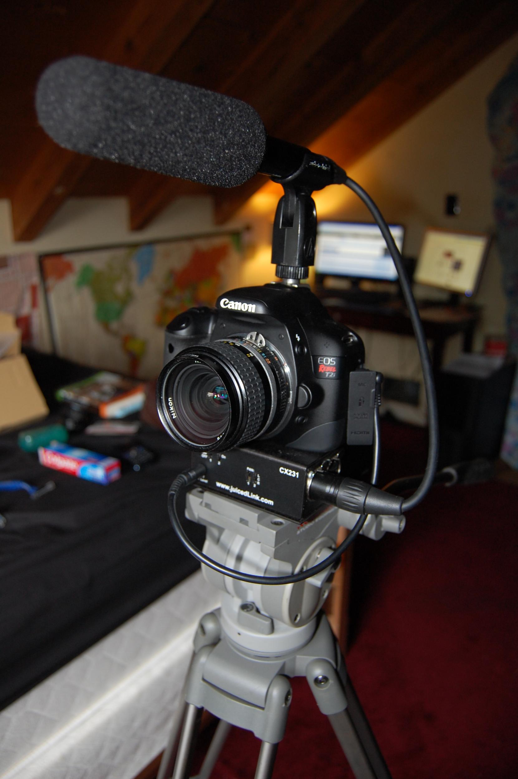

Hello all. I too was interested in Nikon lenses on the T2i and was asking in the forums the other day about an adapter and was refered to ebay where I bought for a total of $11 an adapter that works perfectly. Photos below.
