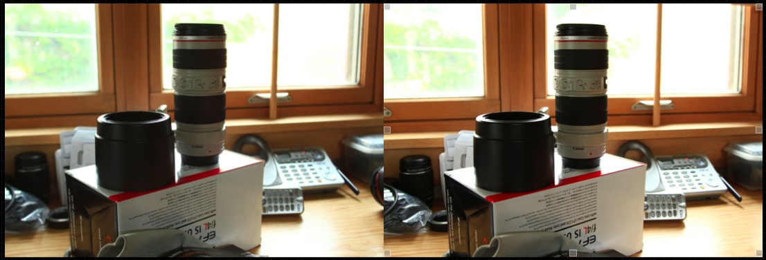

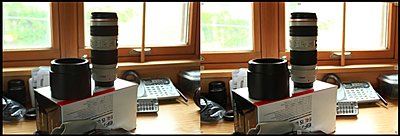

What lenses are you using with the T2i? I use a mix of 40 year old lenses with adapters and new Canon L series and notice a very difference in the contrast, saturation and definition. The newer lenses are not more accurate necessarily (I actually notice they tend to enhance the image rather than reproducing it faithfully) but they do have a greater dynamic range, reduced halos and much better contrast and saturation. The attached picture was taken in as close to identical conditions as possible with a Vivitar 24mm f2.0 and a Canon 24-105 f4L. Both cameras were set at f4, 1/50 and 800 ASA. The left is the Vivitar. UV filters also have an effect, especially cheaper ones. They rob the image of contrast and saturation and, at least in my experience, create a cooler image tint.
Shameless plug - the lens in the image is currently for sale: http://is.gd/e2xMR
Frustrated with T2i colours / tonal range-screencap1.jpg
