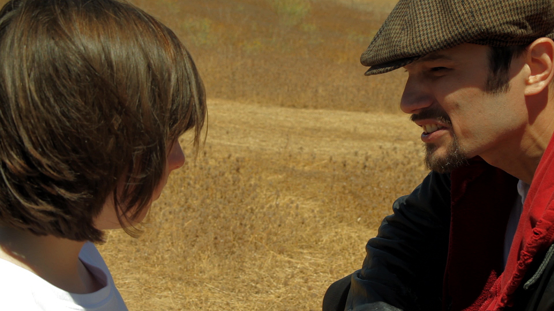

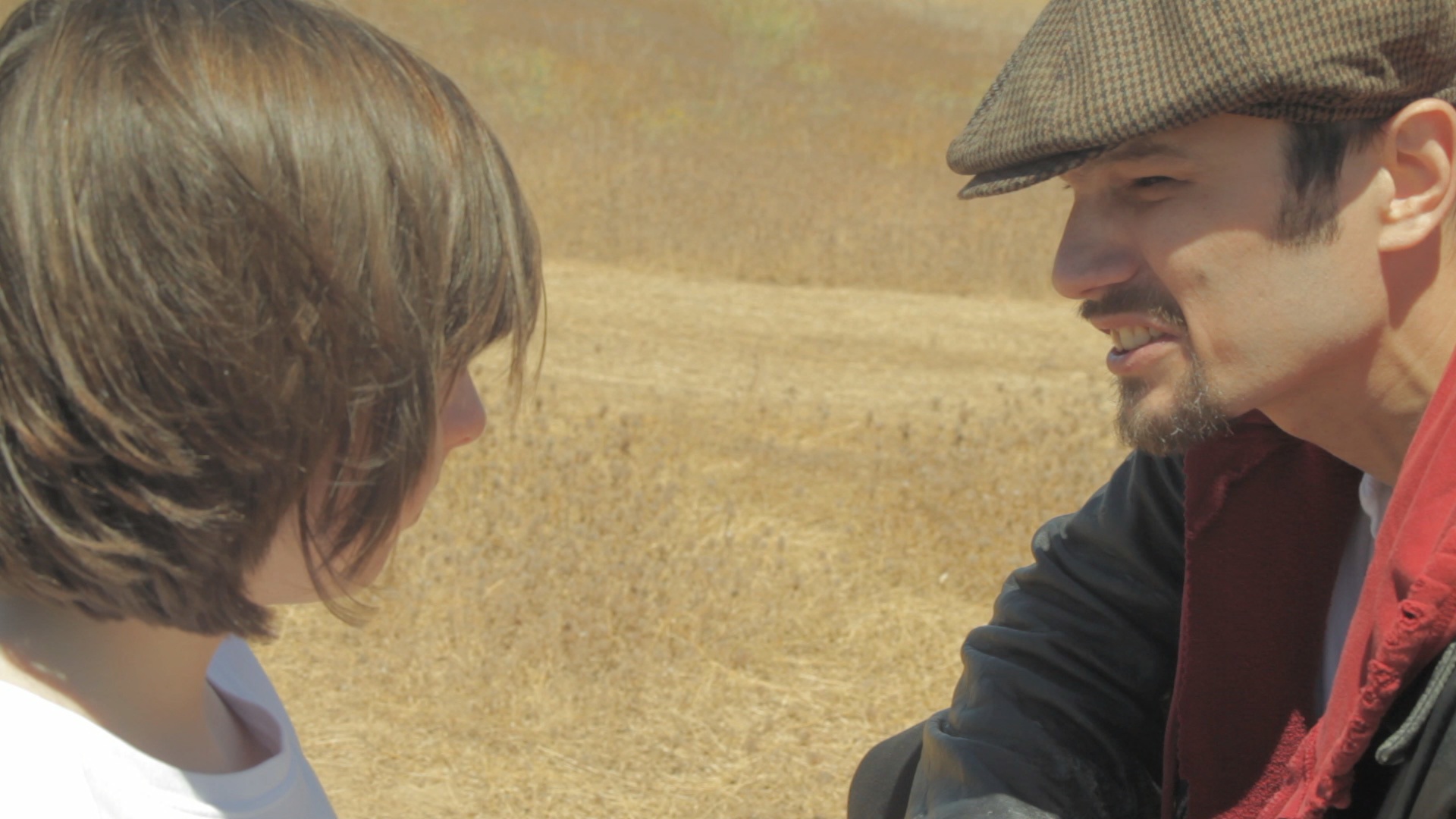

Steve: I have attached some stills showing the raw shot in a Picture Style called super flat and with levels and sharpening adjusted in Vegas.
How to get 2:35:1 ws from dslr?-cineformfromcanonmovfile.jpg   How to get 2:35:1 ws from dslr?-cineformfromcanonmovfilelevelandsharpen.jpg

So you think if this scene was shot without the super flat settings the shadows under his hat brim would have darkened quite a bit?

That has been my experience. This was bright sunny morning about 90 degrees out at about 11 a.m., not a cloud in the sky in Sacramento area of California. I probably shot a little hot on the tee shirt, though I could see just a bit of detail in the shirt. Not saying my color grading or correction is greatest, but here is the entire film sequence of that scene at beginning of the film and more at end.. I know I wouldn't get that latitude on my FX1. Check out the end scene too, which shows blues sky in background.
