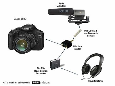

Re: How are you recording/monitoring sound?
So I saw a few videos using a certain set up with a Fiio headphone adapter and what the guy forgot to mention was that it REQUIRED magic lantern to make it happen....so I checked online to see if there was a way to monitor without ML and this diagram showed up.....but on my 60D for some reason I cannot get the sound in my headphones....any ideas?
How are you recording/monitoring sound?-resizedmuligt-hovedtelefon-canon550d.jpg
That looks just to be a simple splitter that sends audio from the mic to both headphones & camera simultaneously. You are not actually monitoring what the camera is recording whereas Magic Lantern on the 60D & 550D/T2i does enable this.
By splitting the signal this way, you will also affect the signal going to camera, depending on the input impedance of the headphone amp.
is there any way that I could monitor or get as close to monitoring the sound without using ML?
the set up with the splitter does not work for me unfortunately...I attempted many different configurations and none seem to work when it comes to listening with the headphones...

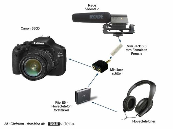

I decided to try using a FIIO 5 headphone amplifier with my Sennheiser G2 going into the T3i. Just as the diagram shows in one of the posts. I connected a Y cable-one side going to the T3i and the other one to the FIIO and then the headphones for monitoring. I know that this is not the same as monitoring the sound going into the camera but is close enough...as long as one takes the time and care to set up the audio manually in the T3i. I did some tests and by keeping the manual volume at a low level there is no hiss. So this works.
However...as part of a small corporate video, I needed to record several voice overs at a client's office and I decided to get a Tascam DR-100mkII, a Rode NTA1 mic and I build a DIY "Porta-booth" inspired box! Couldn't afford the real thing but I built one for under $45 cdn...So, since the Tascam DR-100mkII has a dedicated line out (which will go into the T3i) and a dedicated headphone out, there is no need for me to use the FIIO 5. I can say that the Tascam DR-100mkII has good preamps on their mics and there's no hiss with good mics-even dynamic mics sound good but not as powerful as the condenser Rode NT1a.
The next time I really have to record good sound with the T3i, I will try a regular cable from the line out to the T3i and only if the level is too hot then I would get the overpriced ($40!! ) attenuator cable that is meant for the Tascam.
