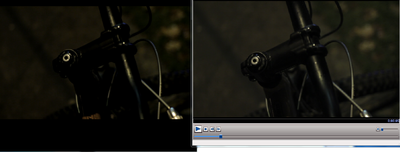

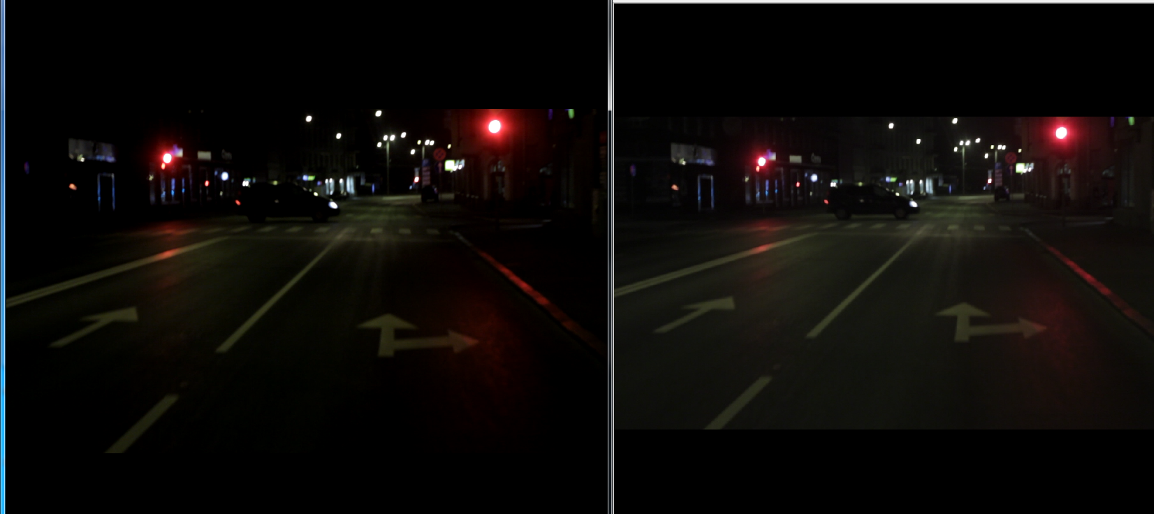

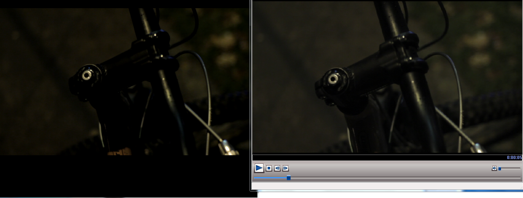

Hello.
I recently shot some night video on my Mir 24 lens(35mm/f2)
Settings were:
Natural 0, -4, -2, 0 (flat)
400 iso
1/50 shutter speed on the lowest aparture. F2
When i shot, the video seemd quite well lit, couldnt complain. Came home, checked the footage on ZoomBrowser EX and it was good aswell.
But then i checked it on Windows media player and it was a lot more darker as if collor corrected. The footage didnt seem flat like i intended and how it looked on ZoomBrowser.
Uploaded with ImageShack.us
The left side is WMP and the right side isZoomBrowser.
My concern is: If i will Collor Correct the night footage it will deffinetly become a little bit darker since i will be saturating/collor correcting the Flat setting video. And if some one, views this video with a WM player latter on he might see it even more Dark, they might not undarstand a thing from it since the Dark spots of video will become pitch black stains, like WMP did it with the Raw footage from 550d. Will it act the same with a rendered video. Does it have problems ust with the 550d raw footage.

Please click on the image again when ur in Imageshack site, it will get larger. And im prety sure the WMP image is some 35% darker then on ZoomBrowser. :)
