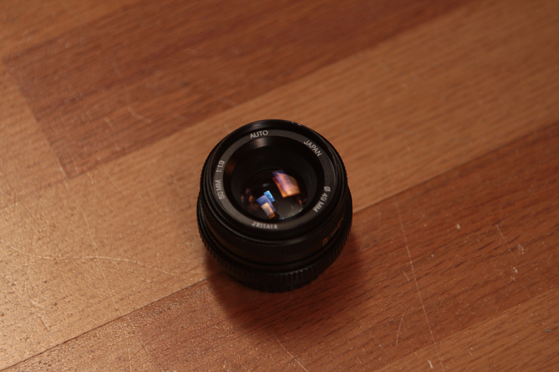

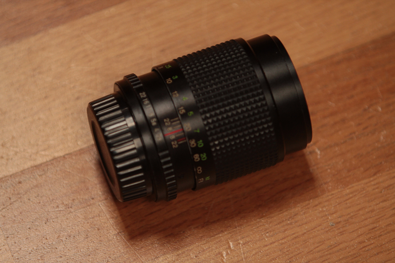

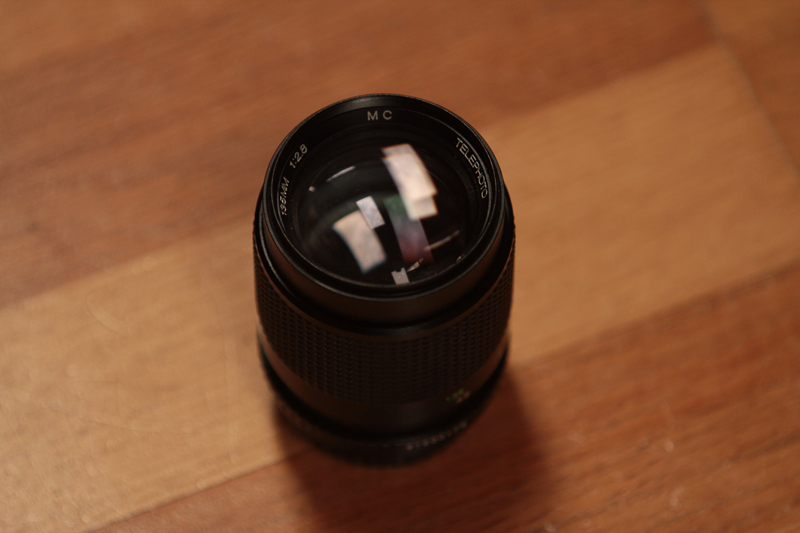

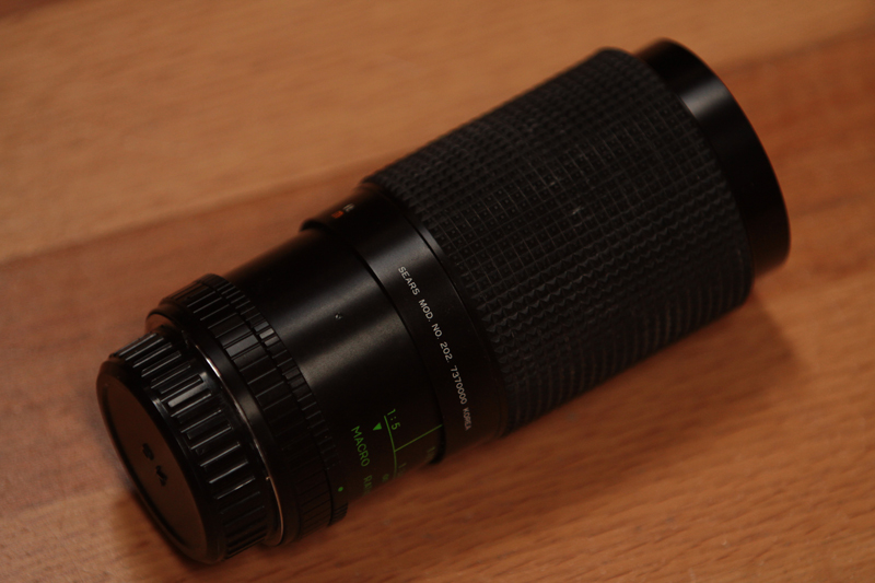

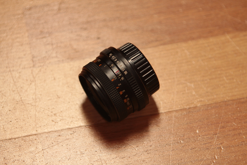

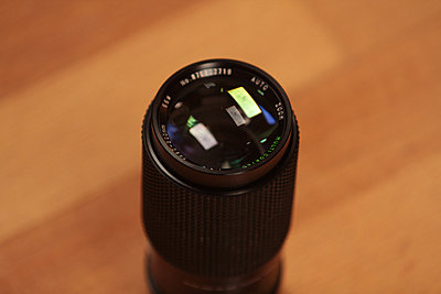

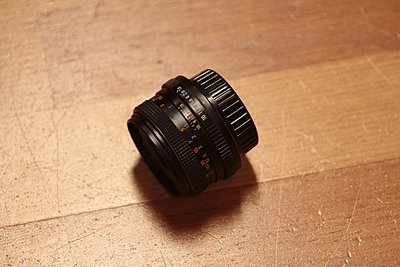

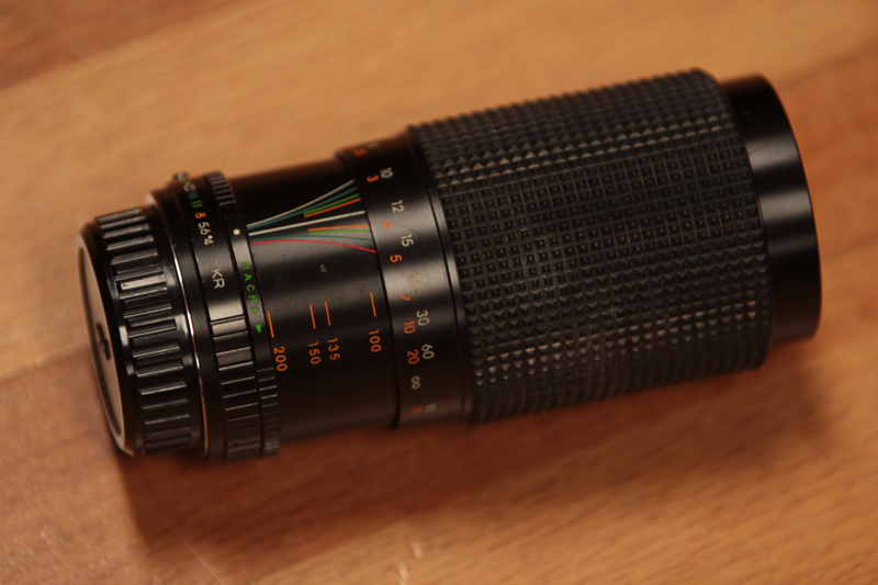

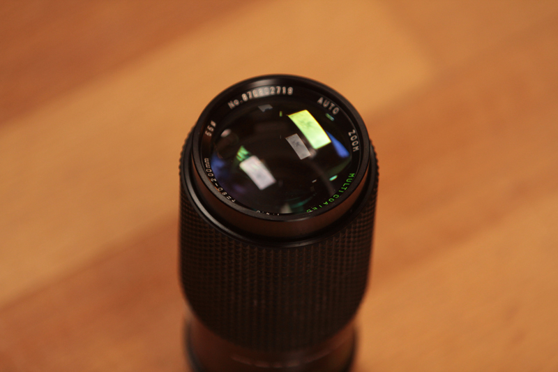

Can these lenses be used on my 60D with an adapter? Can anyone please advise which adapter, if any are available to make these lenses work on my 60D?
Sorry, I don't have any idea which is the right order to write all these numbers down, but this is what I see on the fronts of the lenses:
Vivitar 135mm telephoto 52mm 1:2.8
Vivitar 50mm 1:1.9 49mm
Sears Macro 1:4.0 f=80-200mm 55 (with a 0 and a slash through it after "55")
Please forgive my incredible ignorance here. I just need help in knowing if I can put these to use with an adapter. Found them in our basement! My hubby bought them umteen years ago.
Thank you so much for your guidance in advance!
Old Lenses Found-Which adapter?-135-telephoto-front.jpg   Old Lenses Found-Which adapter?-135-telephoto-side.jpg
Old Lenses Found-Which adapter?-sears-80-200-front.jpg   Old Lenses Found-Which adapter?-sears-80-200-side.jpg
Old Lenses Found-Which adapter?-80-200-side.jpg   Old Lenses Found-Which adapter?-vivitar-50mm-front.jpg

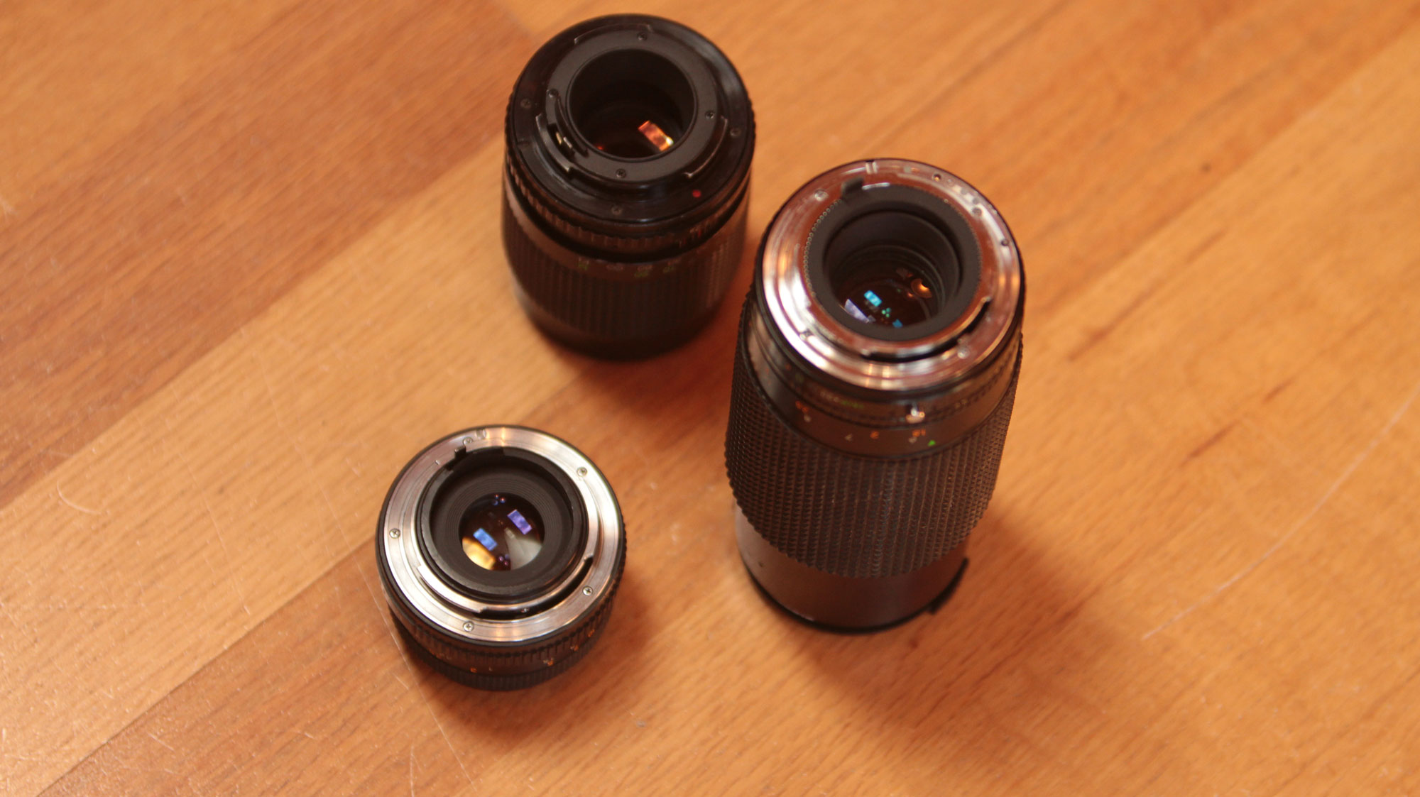

here's a pic.

Hi Lisa,
Originally Posted by Lisa Maxwell View Post
here's a pic.
Nikon look pretty close:
Nikkor Lens Mounts

I'm pretty-sure those are Pentax K-mounts (bayonet) . I have several Pentax mount lenses, and they work great on my 7D for video. PK-EOS adapters can be had for less than $10.
The 135mm and the 50mm should give great service for video. The tele seems a little slow for video. The 55 you mention is the filter size.
MF glass gives a nice loooong throw for focusing, making for lovely rack focus shots.
Good luck with them.

Yes, am pretty-sure those a Pentax.
I think you'll be happier using the MF glass for video, rather than stills. Nailing focus with the viewfinder of a DSLR is pretty tricky, especially with longer lenses. Old-school, 35mm film SLRs had split prisms and brighter screens, that made focusing easier. You could use Live View and magnification, though, if you have some kind of LCD viewfinder.

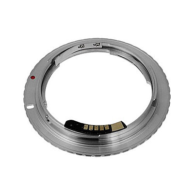

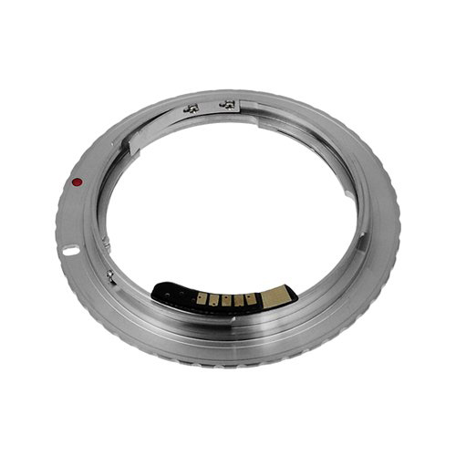

Yes, that looks like the right mount. The focus-confirm chip adds quite a bit of cost to the adapter. And doesn't always work properly in confirming focus on certain lenses (from what I've read). If you search on eBay, I think you can get 'em for less than $10. Many are shipped out of the Far East (and will take more time), but you can find domestic US suppliers, too.

No, that's a screw-mount M42 adapter for the older Pentax, Contax, etc. Screw-mount lenses just spin-on to the camera bodies. The "newer" bayonet mounts refer to the protrusion sticking out of the back of the lens for iris and lens stop-down, and the two systems are not interchangeable.
Type in "PK to EOS" on eBay, and you'll get dozens if not 100 hits.

That is not the correct adapter. It is for M42, which is not Pentax. Pentax is also called PK. To makes things more confusing, older Pentax lenses used the M42 mount, but that type of mount has threads like a screw.
I have a lot of Fotodiox adapters and am very pleased with them. I did a search on the Fotodiox Ebay store, but they did not list PK to EOS adapters, but I know they sell them at their retail store. You could contact Fotodiox through their Ebay store to see if they are going to list one.
