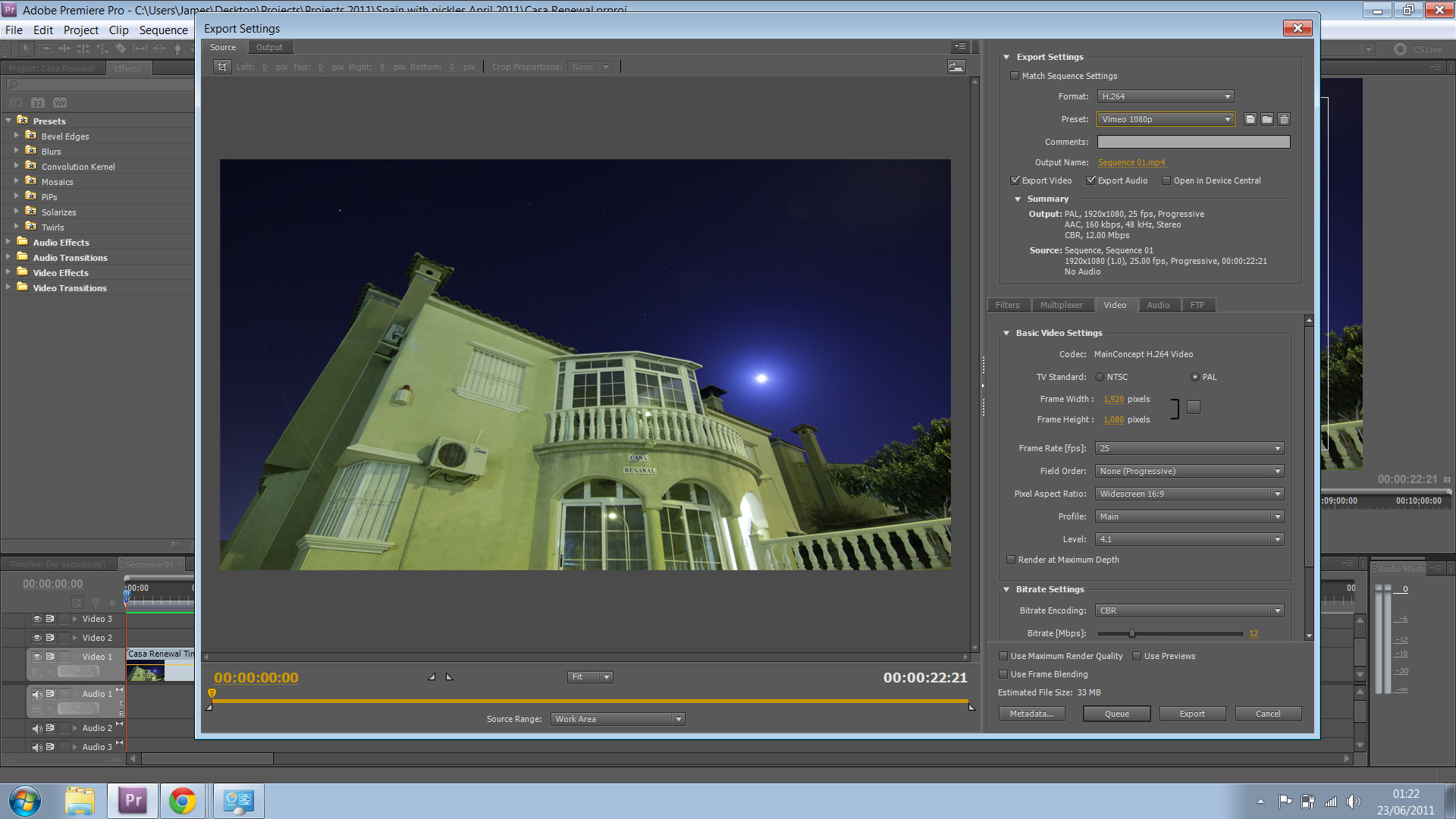

I actually use 12Mbps cbr, 1920x1080, i'm not at my edit suite just now but i'll post a screenshot of the settings tomorrow.

as promised

Thanks James, do you know what you set keyframes to?

Key frames are same as frame rate , so for 25p, key krames 25, for 30p, keyframe 30and so on
