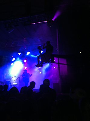

The point of this post wasn't about the laser safety, it was more about what to do now that it has been hit. Do I need a completely new camera, or can just the sensor be replaced?
I was advised and warned by the laser operator before doing the event, so we knew it was a possibility (just tried to keep the camera away from the laser as much as possible, obviously failed). I was faced away from the stage w/ a monitor while the camera was faced at the stage so that my eyes couldn't get hit.
WS of the fraternity party at UGA before sensor got hit:
http://farm8.staticflickr.com/7233/7...64b9f7d3_b.jpg
After sensor being hit:
http://farm8.staticflickr.com/7265/7...7f31117c_b.jpg
Trey Dillen is offline   Reply With Quote
