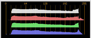

I just downloaded the NeoHD trial. It definitely helped a lot - a few things and they are:
Note: As my reference I’m using the video2.mov sample from dpreview…the blue suit walking near the vegetable market clip:)
I did a straight conversion from the .mov file using HDlink to a Cineform, “high” setting .avi file.
- It brought back the details from the dark areas. You can see details in his blue suit now, and the awning over the vegetables now has a brownish quality rather than the deep blacks it had and I can see lots of detail in shadows now
- It did the same with the washed out white sky, I now have some detail in the clouds, there is more contrast and colour now
overall the colour seem less saturated and the footage handles colour correction quite well now.
I guess most people are getting these results so nothing special...
BTW my scopes show this for the Cineform clip - but in the audio world they have a saying: "trust your ears not your VU meters"
