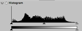

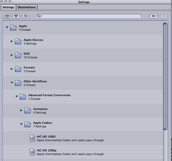

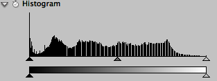

Here's an interesting find:
Before I was even aware of the color space issue with the 5DMarkII, I started using compressor to batch convert my original movie files to Apple's Intermediate Codec, in order to optimize my editing workflow.
I've attached three screen captures. Two of them correspond to the Levels effect in AE CS3. The one with the gaps is from a native 5DMkII clip. The other is the same clip converted to AIC using the Compressor Preset (AIC HD 1080p) shown in the third and last capture.
* I disabled color management within CS3.
Apparently the converted (AIC) clip has more shadow information and no gaps. What do you guys think?

Old January 6th, 2009, 02:32 PM   #6
Location: Philadelphia
Posts: 795
looks like compressor is handling the conversion properly, I'm going to try the same thing to prores and compare the results.

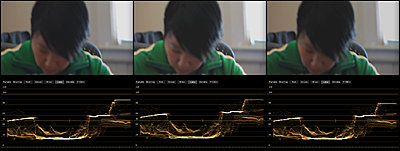

Old January 6th, 2009, 04:03 PM   #8
Posts: 795
Hmm, I don't think this is really working. I just ran the same clip through compressor to AIC and ProRes (using apple's presets), then brought it into Color and compared both with the original. The AIC clip appears to have been clipped hard at 16-235 then stretched back out to the full 0-255 range - detail is clearly lost in the shadows and highlights, and the contrast appears higher than the other two. The ProRes version appears to have been clipped at 16-235 but not stretched back - so lower apparent contrast but the end result is the same with detail lost at both ends.
The image below is the original on the left, AIC in the middle, and ProRes on the right. I've deliberately compressed the luminance on all three to make the clipping more visible - notice the posterization on the hair and missing detail along the window frame in the background.
Mac/FCP workflow preserving 0-255 range-5d_color_compressor_aic_prores.jpg
My latest short documentary: "Four Pauls: Bring the Hat Back!"
Evan Donn is offline   Reply With Quote

Old January 6th, 2009, 05:25 PM   #10
Posts: 795
yes, that's why you can see the detail in the hair & window in the first image - it's the original clip with compressed luma showing the detail that can be recovered using Color. Unfortunately it's not a great example (not a lot of detail to recover) but it was the first clip I found.
