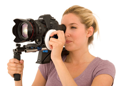

Thanks a lot for the update! Definately a good reference for me to put my $. I have also been deliberating over the redrock micro kit. Do u find the kit a little high up for shooting? I only require 5-8sec shots for rack focusing normally. I simulated a redrock rig and found that my arms will get tired pretty quickly compared to something like the Zacuto sharpshooter rig. I like the solution below but I am thinking of making do without the loupe sometimes.
http://www.redrockmicro.com/cartpics...20_0271_lg.jpg
I saw the rig photos from Glenn Elliot and I think he is right about having the handles at a position that is slightly higher than waist instead of chest level. I like to listen to your feedback on the comfort of using the redrock micro shoulder kit without the z finder. Thanks again!
Could you make a comment on this as well?

I just wanted to report that after two weeks of shooting with the Z-Finder, I am extremely happy with it. I only noticed two factors that would keep me from giving it a perfect 10. The first factor is that when shooting in extreme heat and humidity, the Z-finer can fog up a bit. But to be honest, this can happen with any eyepiece and I found that just breaking my eye slightly away so that the eyecup wasn't sealing airtight around by eye socket was a good remedy.
The second opportunity is the Velcro. I used Steve Weiss' recommendation for affixing the Velcro the 5D MKII body, no problems with that, it has not pulled up or off or become loose, just as Steve said it wouldn't. But the top quadrant of the eyepiece does have a tendency to become slightly looser than the sides or bottom quadrant. It doesn't come all of the way off but it does sometimes become a bit looser than the rest. It is remedied by just using a lot of force and really pushing the Z-Finder down hard to the back of the 5D MKII. It is not bad, totally usable and not a deal breaker. Just in case, I have ordered the Hoodman rubber band strap which can also be used on the Z-Finder. So far I have not needed it but if I am on the road and the Z-Finder does begin to flop around and get too loose, I have a backup to hold it in place.
The optics are superb. The field of view is spacious, you can easily focus and see all of the detail you need to in order to focus using Nikon manual focus lenses like I am shooting with.
I hate to be visually so boring but making the V2 Z-Finder housing all black and or gray would make it stand out much less than the silver that the main housing is made of now makes it. I was stopped by almost every photographer who saw me at a music festival I shot at last weekend, asking me, "what is that eyepiece you are shooting with? Why are you using it? Can I look through it?" Ughh, what a nuisance. Make it all black and or dark gray.
I am very happy with the Z-Finder and if the V2 is going to improve on the V1, it will by far be the best solution out there for the 5D MKII.

Thanks for the report. Despite my initial scepticism that the Z-finder was worth the money I am being talked around:-) I need to use one before I am fully convinced but the more that I use the Hoodloupe the more I dislike it.
There are good & bad points to the Hoodloupe. The dioptre adjustment is excellent (a point that is weak on the Z-finder apparently). I am short-sighted & wear glasses full-time. I can view the LCD screen on the 5DII really well by taking off my glasses & pressing my face right up to the screen. However I then cannot see anything except the screen until I put my glasses back on & then I cannot see the screen without holding the camera at arms length. After adjusting the Hoodloupe I can view the screen through the loupe with my right eye & the scene with my left eye at the same time.
At first glance the optics of the Hoodloupe seem OK when looking directly straight through the loupe but if you are looking at any slight angle then distortion is very evident. You can see the centre of the LCD screen well but as you move towards the corners the view is very poor because of the distortion. So focusing is improved but framing the shot is worse. The loupe also does not let enough light pass so the image is dimmed even with the brightness cranked up to maximum.
From the photos I have seen it looks like the Schneider loupe that is the basis for the Z-finder is much larger than the Hoodloupe so I am guessing that the glass is bigger & more light passes.
My home-made mount with the Hoodloupe glued to the frame of an LCD shade sounds like a more satisfactory solution for fixing to the camera than the velcro or rubber band of the Z-finder. Perhaps all I need to do is glue a Schneider loupe to an LCD shade frame to have the best of both worlds? Adding the i-cuff for extra comfort.
