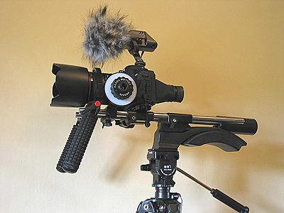

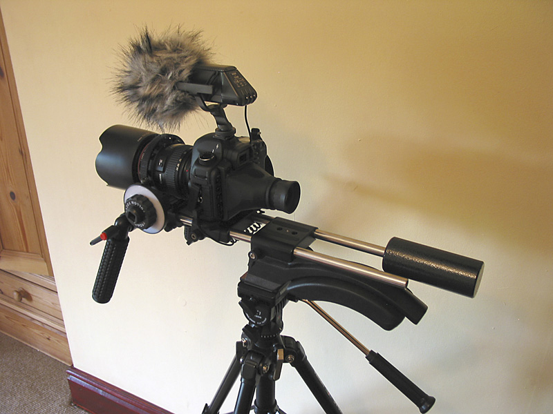

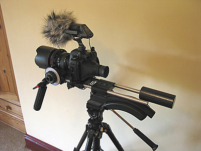

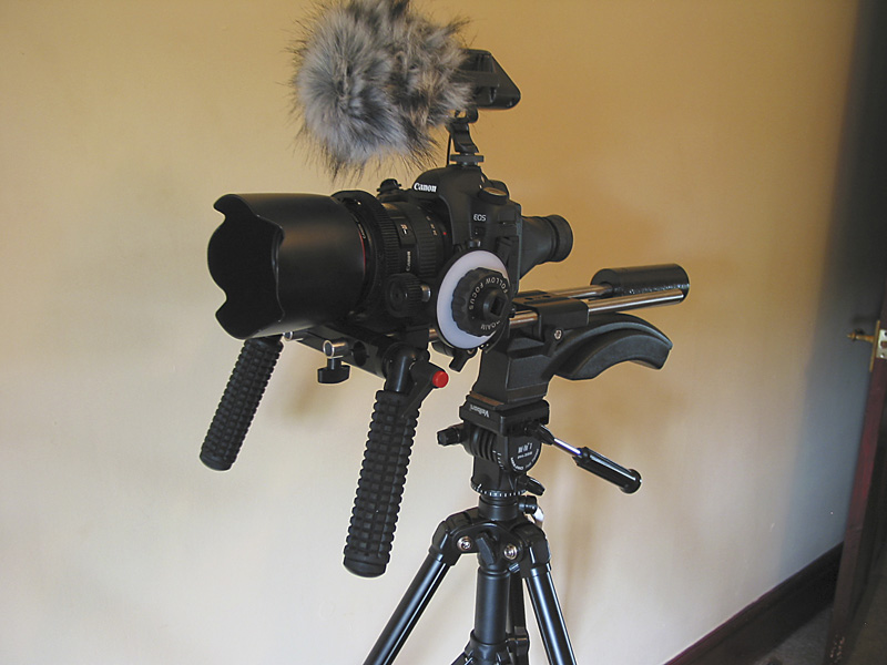

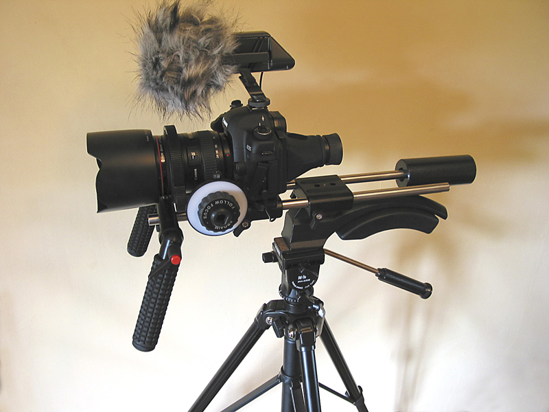

Here's the set up. This is the Cince City shoulder mount and Follow Focus sat on top of a lightweight tripod (too lightweight for this use I think, I would use the heavyweight tripod usually)
I have attached a counter weight from my small jib onto the back which helps with balance both on the tripod and the shoulder. The Hoodloup is glued to the LCD shade's frame (after taking off the shade flaps) and clipped to the eyepiece at the top, held at the bottom with small strip of velcro. The Hoodloup is in a fairly good position for the tripod mounted filming, just by resting the cheek on the nearest bar, but it need offsetting for shoulder work so that it is nearer the eye. I'll have a think about how best to do that.
Using the Rode Stereo Video Mic sat on top which always works quite well for me. You have to be fairly near the subject though.

Thanks for those pics of your setup Wayne.
I have one question though, is it still possible to easily look through the Hoodloupe given that the rails are directly beneath it?

It is on the tripod but not as easy when you're shoulder mounted. I need to offset it a bit. Not sure how to do it, But Ill think of something.
I could just push the rods through the front or at least the nearest one (left) or cut them short and do without the weight on the back.
