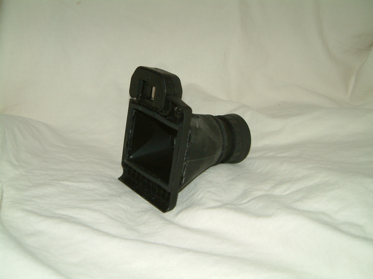

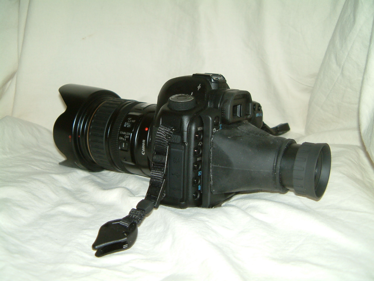

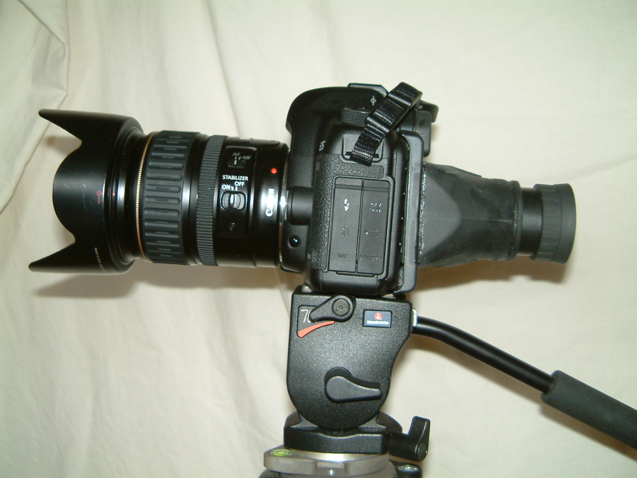

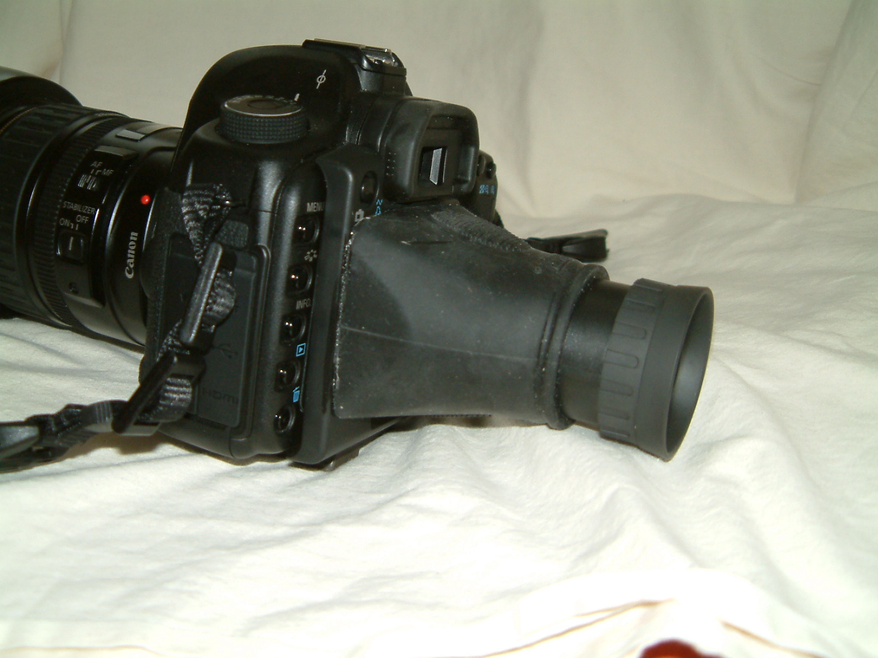

I build a perfect hoodloup from Hoddmanloup and LCD Screen Hood Pop-Up Shade from LCD Screen Hood Pop-Up Shade Cover for Canon 5D Mark II - eBay (item 260383734483 end time Jun-24-09 08:37:17 PDT) and i fit perfect to my camera.
My camera is like any other Videocamera with perfect focuscontrol.
No rubberband who make the Hoodluop difficult to stay in place.

Did you use velcro or some other temporary method to attach the Hoodloupe to the visor, or did you use glue or some permanent method?
Jon Fairhurst
Old June 6th, 2009, 01:55 PM   #20
Posts: 3,531
Judging by the photos he used the same method as I did to neatly(!) glue the Hoodloupe to the LCD shade frame. My assembly works far better than using the special $20 Hoodman rubber band to secure it to the camera. I have ordered the i-cuff to improve function & comfort.

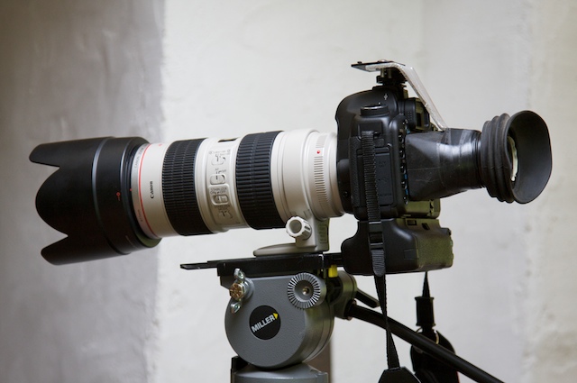

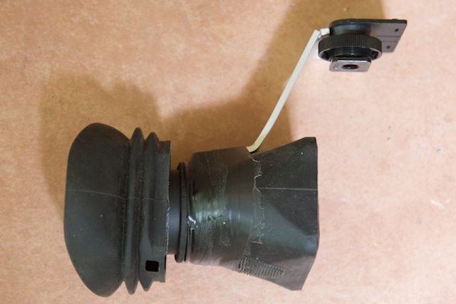

This is v1 of my hotshoe adapter for Hoodloop.
It is very stable. It comes off and on fast.
The plate that attaches to hotshoe also holds a chordless mike or light or whatever.
When I have time I will refine it but for now it works great.

Olof, that looks a vast improvement on the $20 rubber band.
What is the rubber eye-cup?
Old June 7th, 2009, 11:37 AM   #25
Sponsor: Westside AV
Posts: 1,365
The rubber eye cup is from an Pana AG-EZ1u that I have kicking around. It still works but I don't use it any more. And it is a perfect fit.
The eye cup really helps, Hoodman really should supply a better one.
