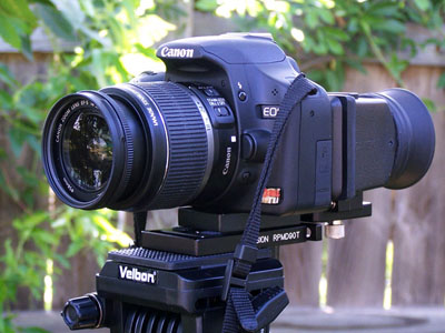

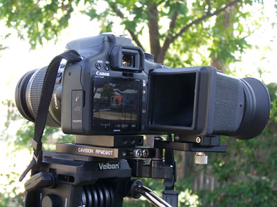

Budget not allowing the 5D MkII, I have the Canon T1i and the same viewing problems.
Tried the Hoodloupe 3.0 with the 12" rubber band and that does work, I experienced some slight sliding around but it was easy enough to move it back into place. The main problem was remembering how to stretch the rubber band around which part of the camera. And the "tacky" look of the RED rubber band (only color the 12 inch came in with the Office Depot package) made for something I didn't want to be seen with.
So I ordered the viewfinder assembly for the 5D MkII from CAVISION in Canada. They knew there were some differences in LCD position between the 5D MkII and the T1i so they modified it somewhat. A "riser" part to get the camera up a bit higher, and they called back to suggest that I go with a "swing away" attachment (good advice, BTW). Since this was designed for the 5D MkII even with the riser the hood fits a tad high on the camera and can obscure the bottom of the LCD where shutter, f stop, and battery status is displayed. Being able to swing the whole thing out of the way lets me see that data. This is not a problem for the 5D MkII. Price was $239 incl 2 day shipping.
The eyepiece is a 6X lens group, body construction similar to the Hoodloupe 3.0, and the view is great. Like the viewfinder on a much bigger video camera, image is big, bright, and clear!
I'm happy.
It's not quick attach or detach, does take a minute or two to put it on or take it off but when there's serious work to do I'm glad I have it. I do still carry and use the Hoodloupe but usually don't attach it with the rubber band although I keep a couple of those in the bag. I put the lanyard around my neck and when I need the hoodloupe just lift it up and hold it against the screen, the same way the Hoodloupe was designed to be used to check your still images.
Anyway, here's a couple images of the CAVISION viewfinder on my T1i.
