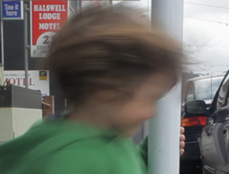

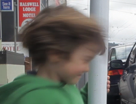

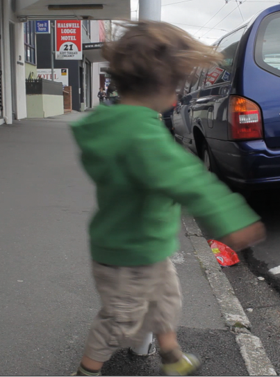

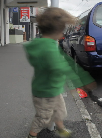

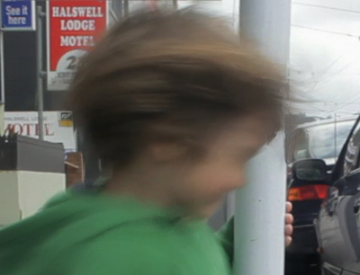

Hi Mark, actually I use compressor all the time. The bad news is my settings were correct - it is doing interpolation. However, most scenes I shoot don't have such rapid movement and Motion fairs a lot better.
"High quality motion compensated" is the critical tab to have checked.
Here's a couple of frame grabs to demonstrate that with identical settings (only 25p this time) interpolation is taking place, but... it has the kind of blur one would associate with frame blending, just not so severe.
On the close up (100%) you can see on the HQ motion compensated 25p version the pole distorts in front of my son's head as Motion generates a new frame. On the 50% shot, four frames later, you can see how Motion struggles with the arm, just as it did in the stream shots I sent you.
For reference, I have attached grabs from the 30p original and the 25p frame blending version. You can clearly see the differences.
