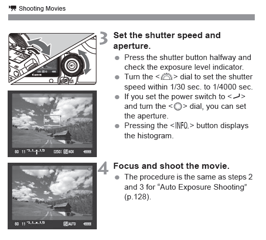

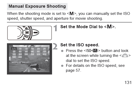

Hannu,
On p 131 and 132 it does state you can see the histogram in manual mode.
And it works very nicely for me at least.
